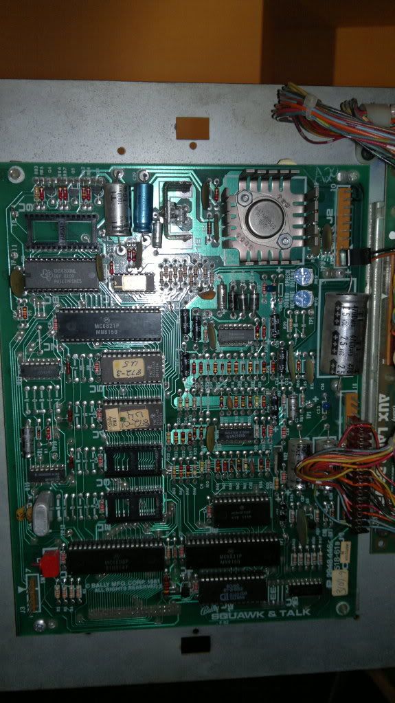

1. Does anyone have a pic of the Squawk & Talk board, I have a two prong plug (speaker?) that I'm not sure where it goes. Couldnt find a clear shot online, so I figured I'd ask.

Heres a pic of my squalk n talk.
connector on the far right,it connects to the bottom 2 pins HTH

Yeah, thats how it is plugged in. Still no sound. I get the 5 flashes on the S&T board though. And yes, there is a small board with a relay on it "Solenoid Expander Board"
Checked the test points, everything seems to be ok. Jeez. OK, got the sound working. Rewired the speaker so all is well. Anyone with ideas on the coils? Also my GI doesn't work, but the computer controlled lights do. ideas?

Oh and to clarify what was wrong with my sound, I believe it was the volume pot that was on the coin door. I don't know if this is like this from the factory as there are volume adjustments on the S&T board itself, but once I bypassed the coin door volume pot, it worked flawlessly. Not sure yet if I am going to replace or leave it the way it is now, I don't adjust the volume that much.
