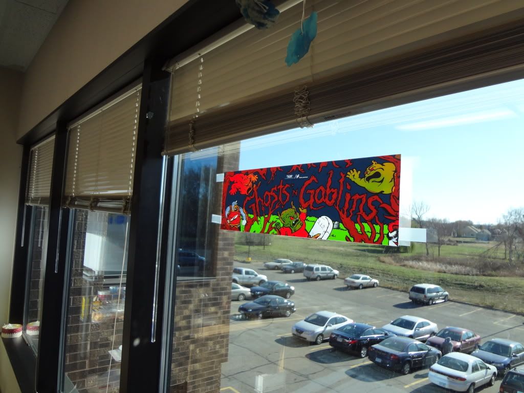

Do you guys mount the adhesive backed ones to clear plexi or frosted plexi? I noticed with my last one that I had to add a layer of white adhesive vinyl to the inside of the plexi to diffuse the light a little, as the marquee's colors seemed to get washed out otherwise. I just got a repro translite from GameonGraphix and I just wanted to know if I need the extra diffusion or are his colors strong/opaque enough to prevent washout.

Well here are some shots of this one mounted to my office window. It actually looks pretty rich, even being back lit by the sun. I think I'll be OK with clear plexi.

translites in general just suck but would recomend applying them to 1/8" white trans plex
than using 1/8" clear on top. or if thickness is an issue use 1/16"
and Marquees with alot of Black will always be a problem.
and/or use lower wattage bulbs or diffuse the tube
