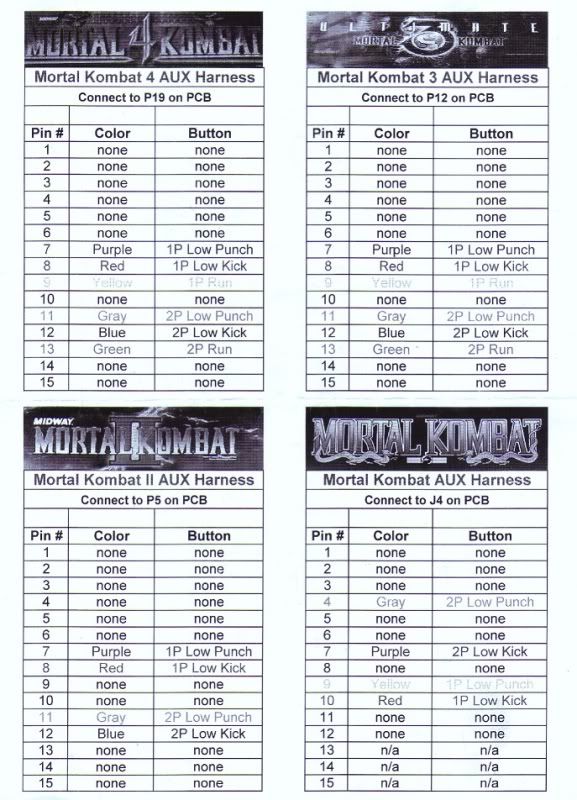

I will check once I get home and update with pictures what I have in there. I looked for a total of ten minutes didn't have much time, but hopefully the cables are there. Also the kick harness is Seperate as well? The low kicks punches and runs do not work. My buddy said I needed to splice the wires in. In my mk 2 it is a Seperate plug labeled player three I believe. This one doesn't have it.

You're LK/LP/Run shouldn't be working because nothing is hooked to the P3 connection on the PCB.
You're going to have to map out what the pinout is for that coin door connector and run the wires to the board to make it work.

This might help with your LP/LK/Run wiring...
Okay so i finally got around to getting my mk kick harness wired! Just got in my mk owner book so I have to get the coin door wired.
