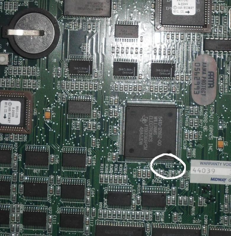

So i'm working on a UMK3 Wolf Unit and I came across something interesting, the U33 Custom Chip comes up bad but when it does during the boot test it says UE13 is bad on the screen...
Now I've looked all over this board and well tho I may have glasses and might not see the best , I cannot for the life of me find this chip! >.<
There are only 2 chips on the board that i cannot ID and that is the one next to Xtal Y4 and the other is between U53 and U61 (next to U59)

I know where U33 is
lets talk about UE13 which is displayed on the screen.
Come'on man i know your better than that. :D
edit: i guess i should have clarified in the first post, not worried about u33, i wanna know what's up with UE13 lol :D
Ah, sorry. Looks like I mis-read what you were trying to convey. I just noticed that the text says UE13 but the image shows U33. That's my bad. There is no UE13. That's why you can't find it. U33 is the main processor for the Wolf Unit's. UE13 was the main processor for the T-Units. They simply goofed on the text when they designed the Wolf Unit. Basically, it's a mis-print. It says UE13, but it's supposed to say U33.

That's not the main processor, it's a DMA controller.

i'm probably not going to mess with it or maybe my buddy will come back from his repair vacation :D (i've got a fairly large stack of boards that need attention). I did think to re flow the joints but I'm worried about bridging one or more of those joints.
For giggles i decided i'd try swapping the roms out with another board that i was having issues with (a rampage world tour). Funny with those roms installed it actually calls U33 the correct name U33.

My trick is not to use any solder (re-flow the existing), if at all possible (on those very closely spaced legs) - or a microscopic amount on the end of the iron tip if the contacts don't bond. Make sure the contacts are as clean as you can possibly get them. Don't put the solder line near it (like when doing through hole working) or you will bridge the pins. You need a really steady hand too, don't blame you if you pass on it.

I would think if you hit it with flux and then drag the iron with solder in one motion across the legs the solder should all go where it needs to go.

Yes, that SMT chip is a common one for solder cracking.
