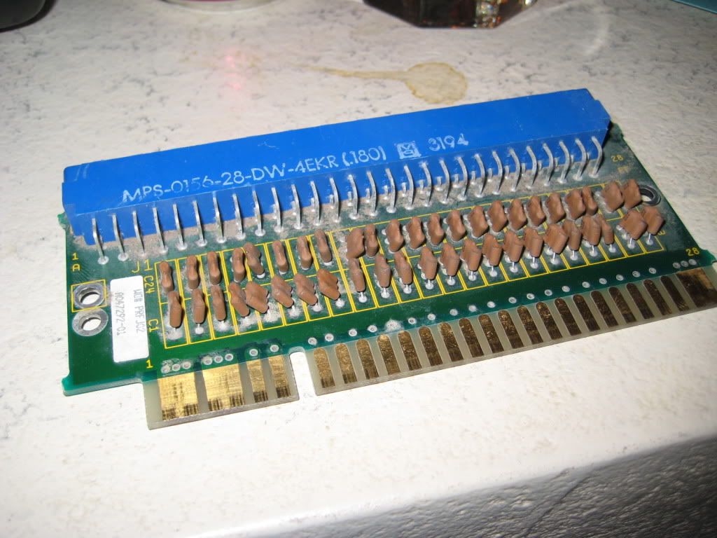

So I've had this mortal Kombat 2 cab that was converted into the amazin' primal rage.
When I put a mk board I get the fast vert scrolling you would see with a hz issue.
But this being an original mk2 cab I'm not sure what has been changed for primal rage since both games are jamma +.
Help me out with where to start ,

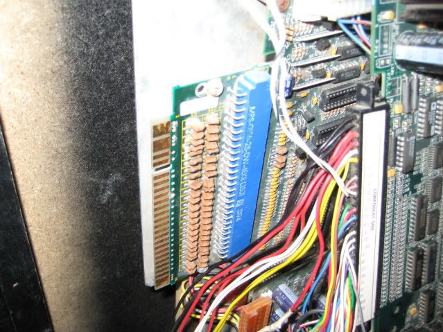

And what the board is between the harness and the primal rage board.(pic)
Heres the pic of the board on the primal rage
dabble with your Horizontal and Vertical Sync pots on the monitor remote adjustment board. in a Midway cab you can most likely find this mounted underneath the metal monitor glass bracket (meaning you need to unlatch the control panel). they might alternatively be called H-Hold/V-Hold.
not all game boards are the same. this is predominantly why I abandoned my "Multi Kombat" project because I didn't want to have to keep adjusting the monitor for each game.
Heres the board on the primal rage board, on the back it has rev b. 'atari 89'
I just dont remember seeing one of these on a primal board before...
what is it for?(other than being dirty)

Vert hold fixed it thx, I was thinking it was a compatability issue like when using a supergun on a sony tv with a midway board etc...
Thanks
The small board is just a JAMMA filter PCB. Not needed at all. It's supposed to stop EMI but does it really?
