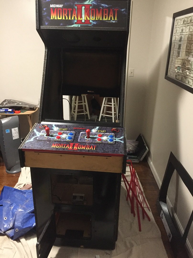

Not much of an update, but here's a picture of the cab with the marquee I got from Szabo's Arcade, and the CP that i put together from original parts and boostin4hp's metal and wood panels.
Can't wait to get this one finished. Turns out, the "bad" harness in there is actually in really great shape.

Okay, quick update. All of the artwork except the control panel box from This Old Game has arrived and been installed. Have the CP finally wired up after hacking apart a Gauntlet Dark Legacy wiring harness. (Apparently, MK2 Jamma harnesses and control panel wiring are closely hoarded items that never appear for sale. :( )
Have an NFL Blitz/Showtime Jamma harness coming in that I will only need a few tweaks to in order to have it match up with a dedicated MK2 harness.
The monitor has been fully recapped and I'm now just in re-assembly mode.
I have ZERO clue how the hell I'm going to get that monitor back into the cabinet though. I'm thinking of removing the crossbeam that the remote board attaches to so I can get some free space with my hands on the bottom of the monitor. Having two bad shoulders does not make this easy. Putting the monitor back into my HS-5 cabinet was a breeze compared to this. Just pray I don't neck the monitor when putting it back in.
Pictures will come once the monitor is in and the outside of the cab is basically complete. Then a TON of pictures will come forth. :D
It's hard because the cp area is so deep. I recommend doing the CP top last so you can rest the monitor on top and not worry about scratches. It's not an easy job, try to get a buddy to help.
Ha. I had forgotten that I had left this thread hanging. Yeah, I eventually got a buddy to help me lift that thing in there. With two of us, it was actually very easy. Single person, not so much.
