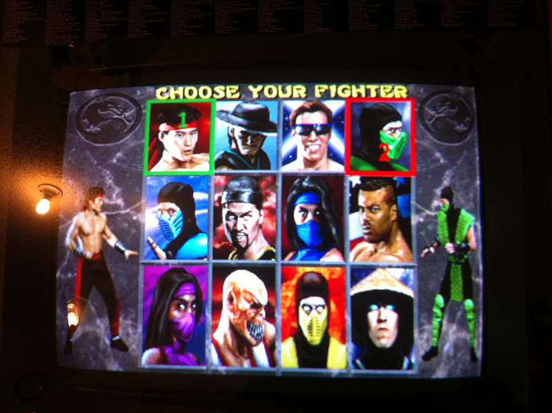

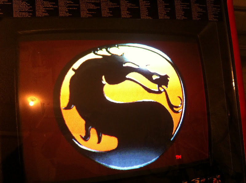

I'm getting some distortion. The screen is squished on the top, bottom and right. I have tried using the adjustments pictured below with no luck.
Distortion is apparent when viewing the squares which are all supposed to be the same size:
Logo is squished on the top and there is black space:
Right player is distorted and player squares are different sizes:

I'm leaning towards your monitor being one of those Sharp Image ones. the adjustments you seek are not going to be on your remote adjustment board or on the flyback (the black box thing). instead, they will probably be pots on the actual deflection board (the chassis) for Horizontal Linearity (this will fix the squishing to the right) and Vertical Linearity (this will fix the squishing on the top).

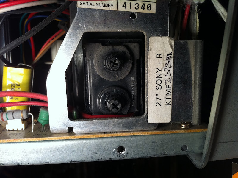

Hello there. I am finally getting around to fixing this issue. I have taken pictures of the inside the best I can (gallery: ). I do not see a horizontal or vertical linearity pot anywhere. I am in the process of searching the web to see if I can get this sorted out myself. In the mean time, I thought I'd reach out. Any advice would be appreciated. Thanks!
The service tag does seem to match with mecha's note about it being a Sharp Image 27" monitor. I'm extremely new to all of this so I'm curious as to how you make out with it as well.

wow, me 10 years ago. what a knucklehead. LOL you have a Kortek something, maybe it is a Sharp Image rebrand. I genuinely don't know what does, if it's a B+ adjustment I think that might be moderately reckless they didn't seal it. look around the heatsink surrounding the flyback, should be a KT- model tag around there somewhere. I don't do anything with these so I don't really know, maybe KenLayton or Ohmerone can weigh in.

Your Chassis is missing the Pincushion Board
do you see the Male plug? near back of chassis
Its a small board needed to control the Pin amp
transistor that's on the Heatsink
Do you see the Small transistor covered with the
Thermo Pad on the Top side
on the FBT heatsink ?
it has a quick disconnect plug.
The board will give the adjustments you need
to correct the over all geometry.
