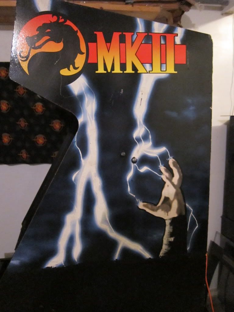

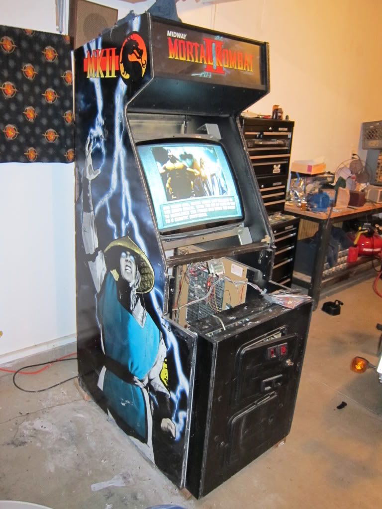

6/8 Update:
Got to put the kids to bed tonight and began starting the other side. Some scuffs and the like but I got the technique down now with better results. I used Citristrip again and hammered out two sections within the hour. Followed up this time with a generic green dish scrubbing pad and got the leftover paint off much quicker too. I'll have the cab finally stripped before all the rest of the cabinet parts come in by Thursday (hopefully). I got a MK 1 complete control panel coming from Ctozzi and a manual from the Arcade Boneyard that came in the mail today. Props out to them as well as our standard vendors for T-molding and leg levelers. I'll have the final set of updates after I get it done. Had some issues with the AC voltage and a ballast that was posted on the repair forums too. Thanks for all the help KLOVers! I know it's not a showpiece but will be fine for my taste!

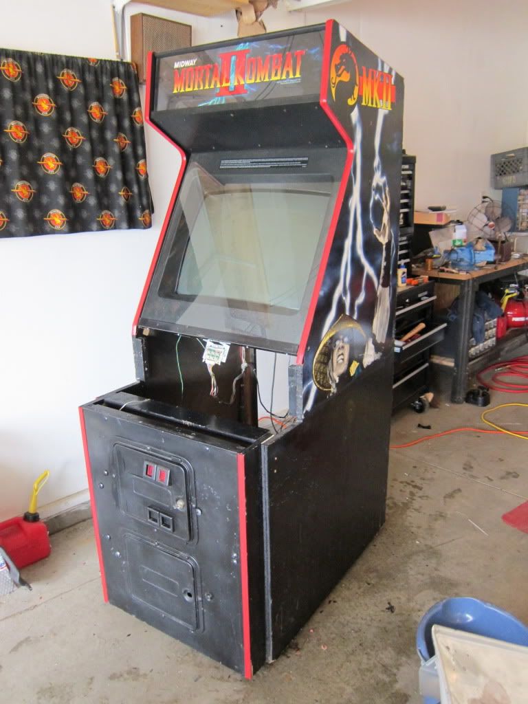

6/12 update:
I'm at a stand-still until I can relocate some parts for the control panel. I got a dedicated MK1 control panel box but need to change it out cosmetically and look for the right joysticks and wiring. I think Citristrip changed their formula to a more liquefied solution-- don't care for it too much. I'll have to hit up the local hardware and hope that the last jug on their shelf is from the same batch.

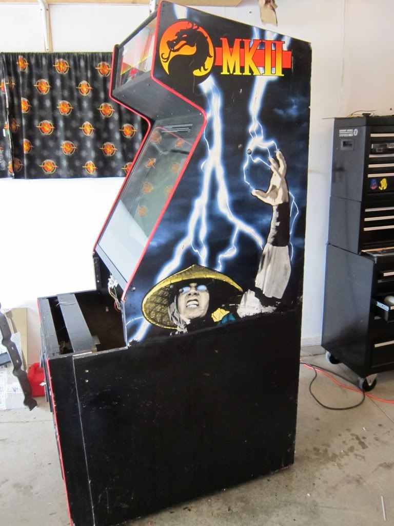

Here are pictures of today. Did another section of stripping, neighbor came over and helped me while I fastened up the leg levelers and plates, got some new red T-molding on the areas stripped. I had problems with the front portion of the cab being pried loose from the sides. Apparently someone pried it farther apart to fit the NBA 4-player control panel on it, weird. That has been fixed as well. Enjoy--

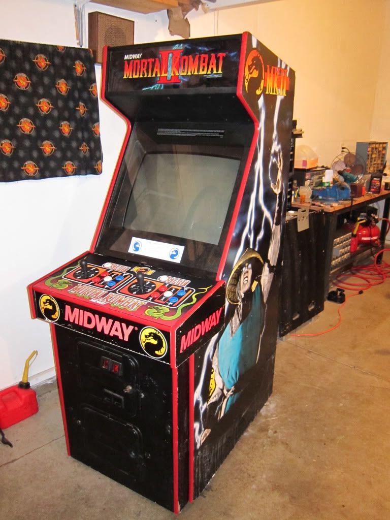

Final Post:
Pretty much got all the wiring of the control panel figured out today. I had to scratch build a pair from junk I had in my parts pile, what a mess! I know the CP and CPO aren't dedicaded MK2 but it will work for now since I had NOTHING to begin with. Maybe sometime I'll spend some cash and get a dedicated CPO if it warrants it. I have one small section on the left side that needs stripping but that's about all. Side art isn't perfect but it looks better than black paint.
I wonder if anyone bought a set of side art from mammarquees? I noticed that they sell a set for $189, to which I can't spend the funds on.
It was fun to do since I never really tried a restoration before. I can understand how time-consuming it can be for sure! I just need to order a cap kit from Bob and I'll be all set for now, thanks for all the help and input getting this thing going everyone!
