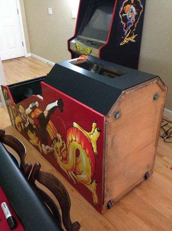

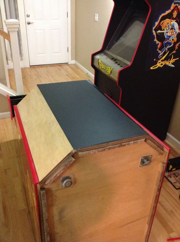

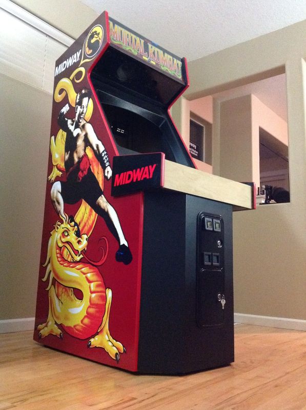

I was talking with BioMech and he said that he found black vinyl on the front of his MK1. is that how it was done by midway? or was it painted?
I would like to now, because if that is the case, I would need to do black vinyl. to tell you the truth, the access panel there is on the right had black vinyl, and I thought the previous owner did it.
Yeah my MK1 also had black vinyl on the front of it as well. It had some bad spots so I filled with wood filler and sanded smooth. Then painted with plasti dip so I could peel it off if I didn't like it. So far it looks good. I've been wondering if the vinyl was factory if so I might have to order some.
yep it's factory, all of the 90's midway cabs have it for the most part. Thisoldgame carries what your looking for to replace it.
