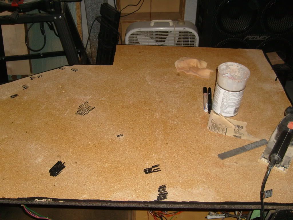

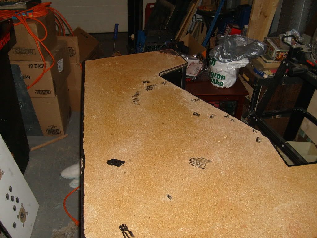

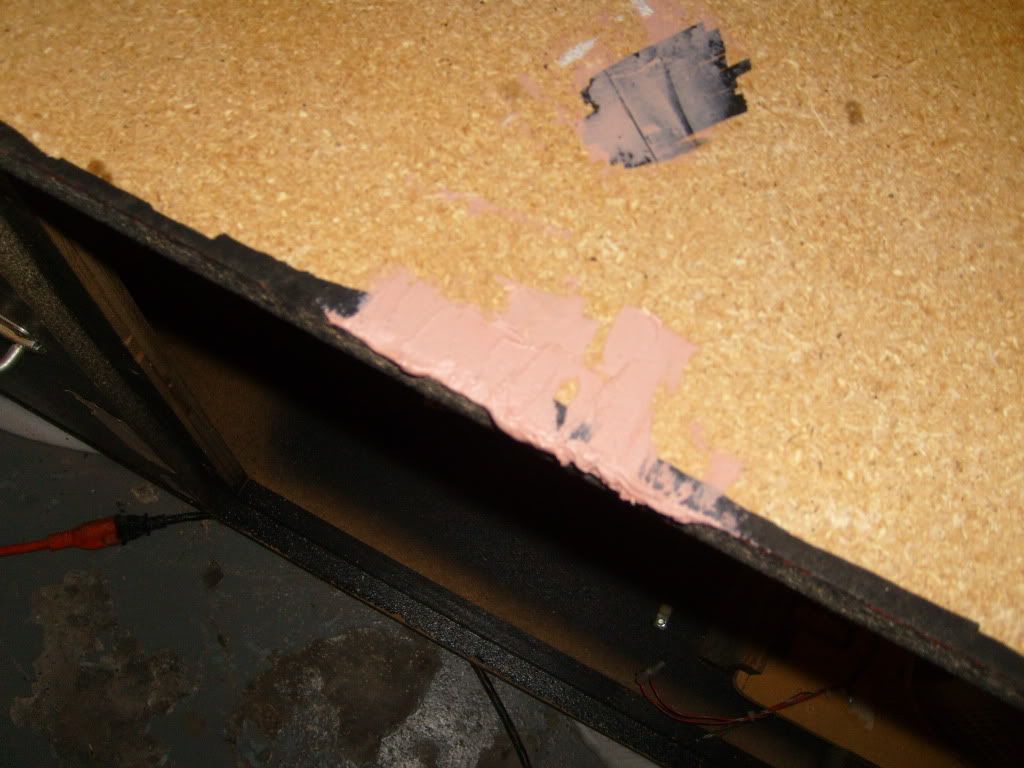

Cabinet stripped and sanded. Used a method of Biomech's in coloring around the edges with black. Used a black woodcraft paint marker.

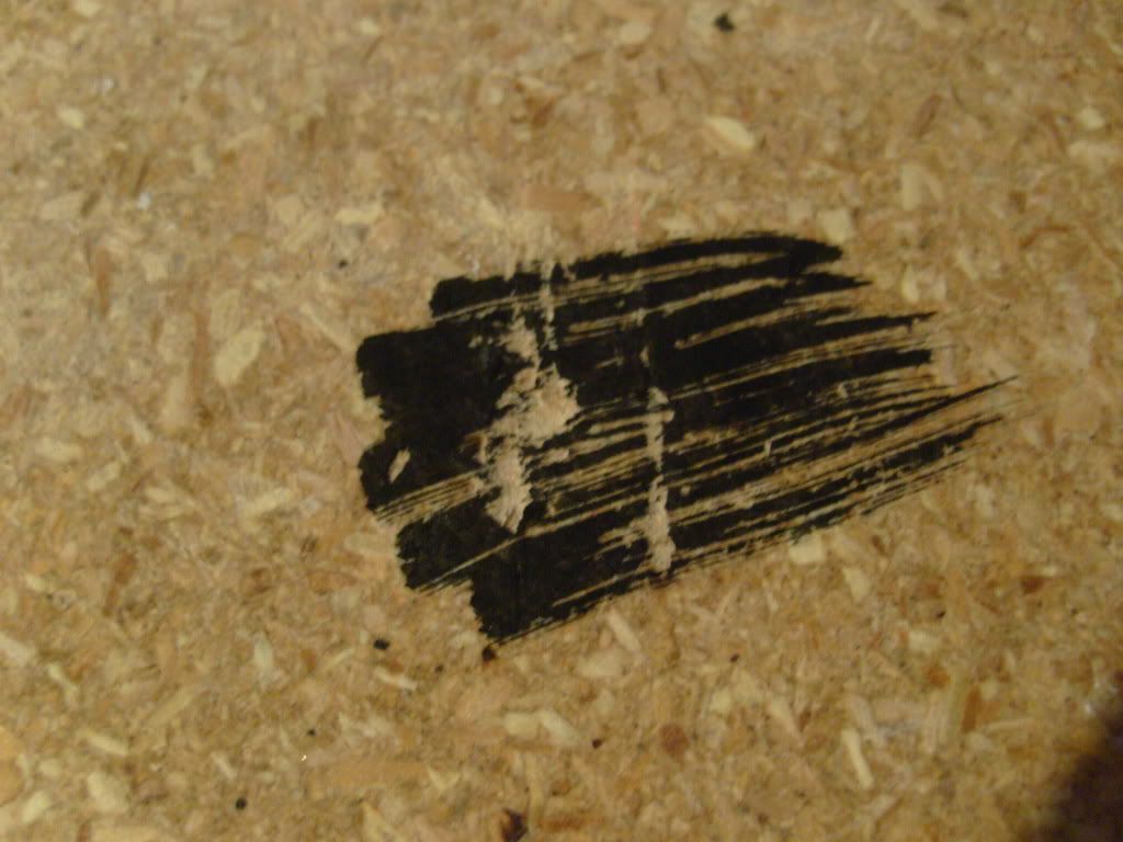

Also used the marker to sort of dry brush areas that needed filling so I could see and fill them all in one go.

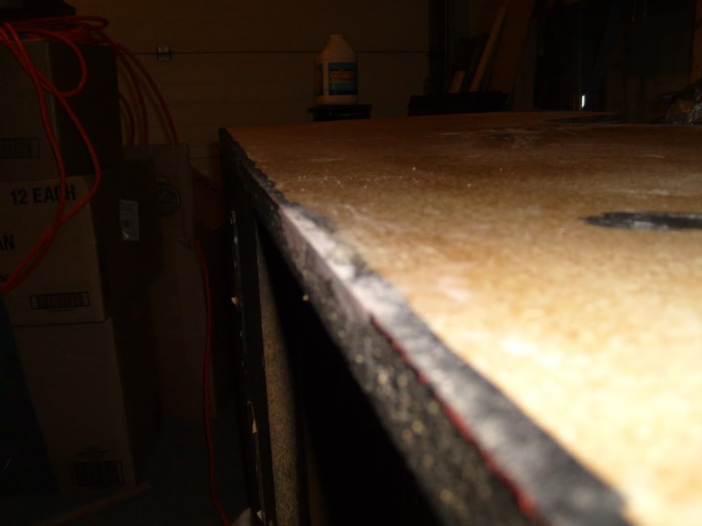

Edges filled.
Same edge rasped and sanded.

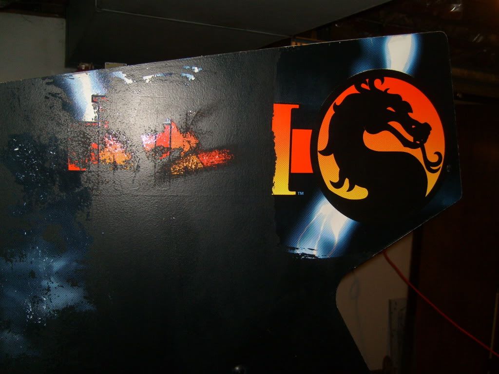

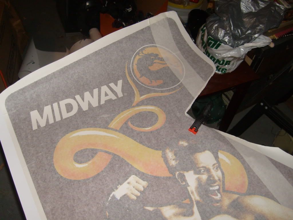

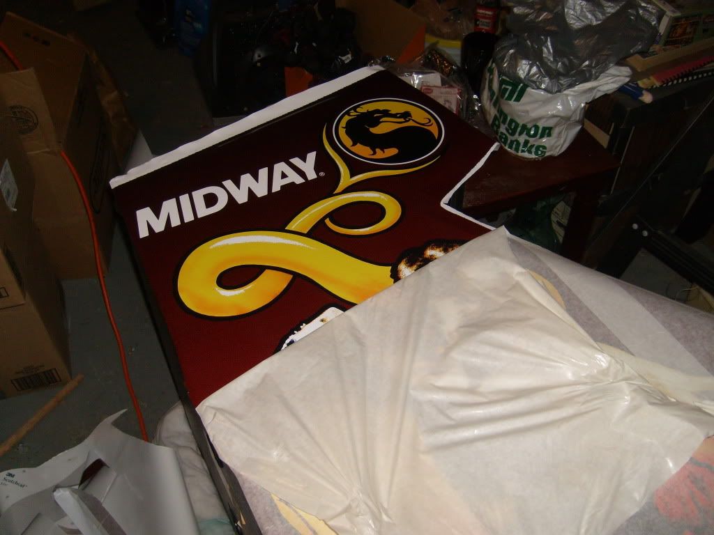

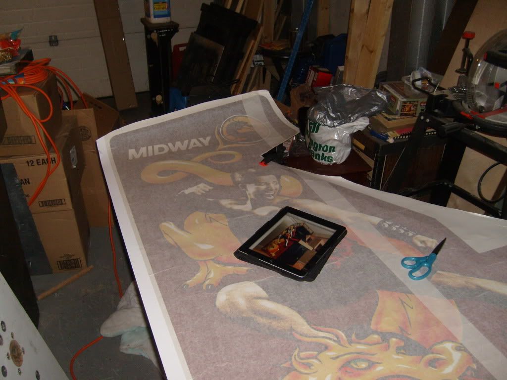

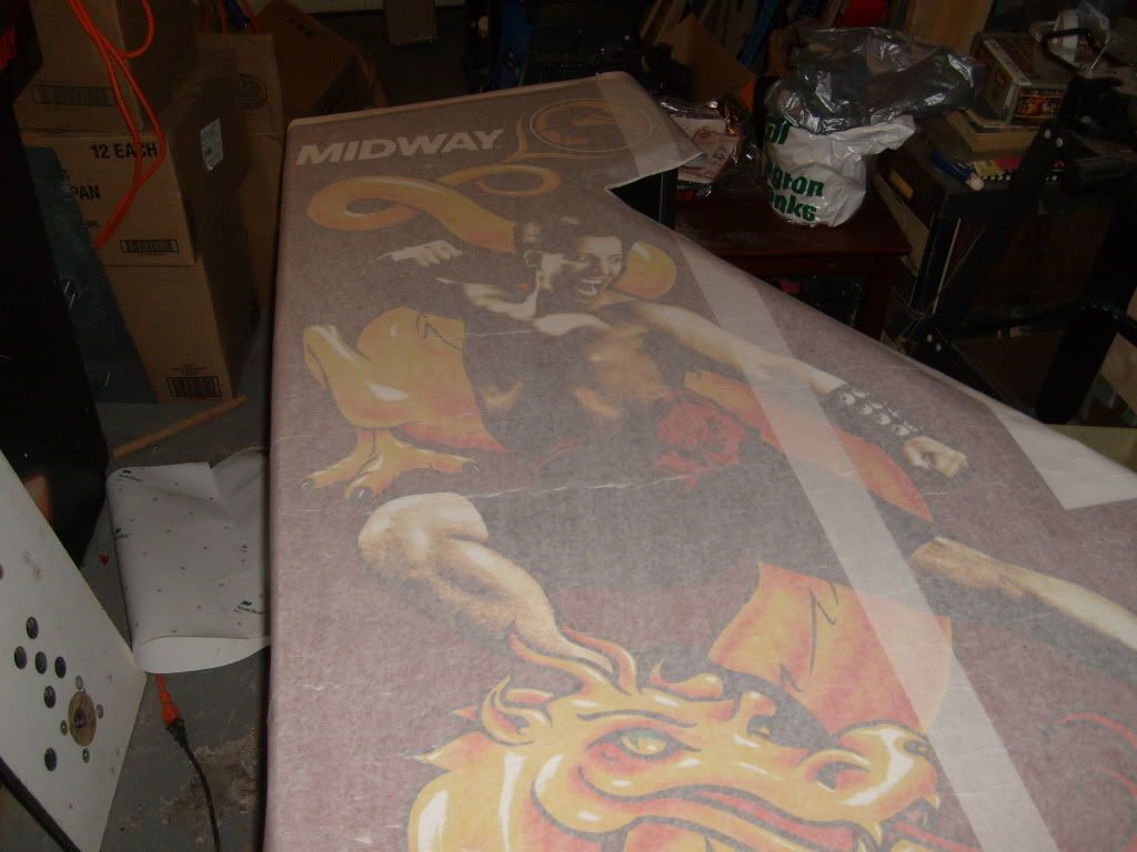

After wiping and cleaning cabinet, side art laid out.

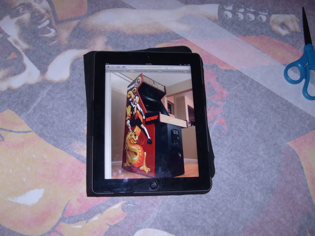

Using my Ipad to check Biomech's cabinet for placement.

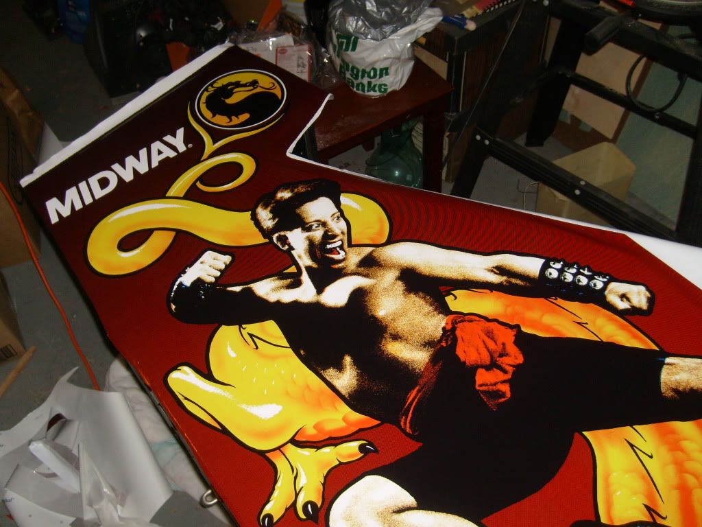

Artwork fully attached.
Starting to remove premask.
Premask gone.

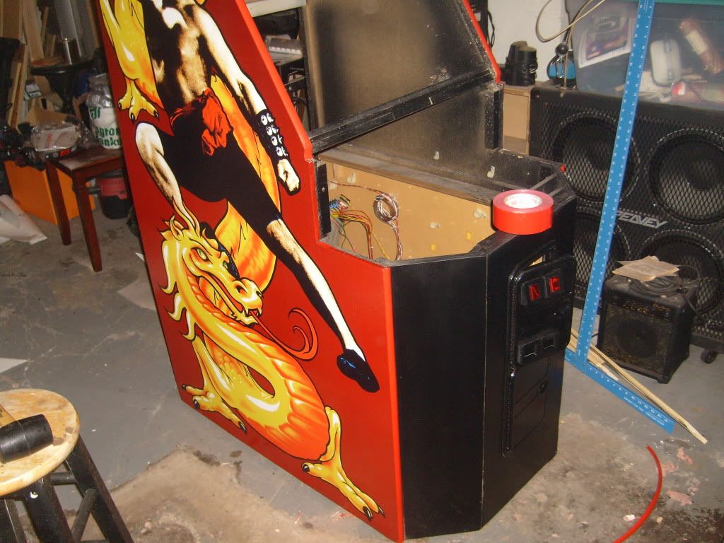

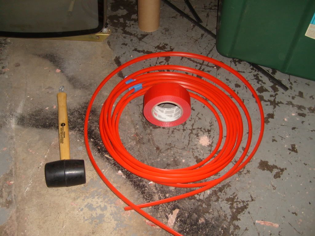

After trimming edges, these are brought into the picture...literally.
The red duct tape is used to help the tmolding fit tighter into the slots.
And Voila! A piece of art!

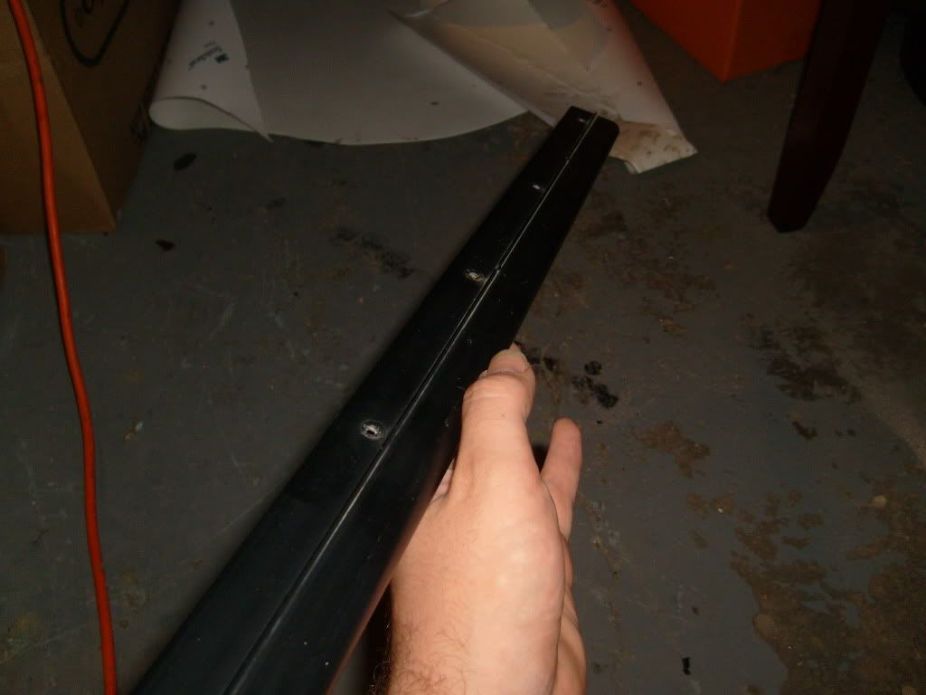

One quick question to Biomech and everyone doing a restore or who owns this cabinet. Do you have this problem? The Midway logo is cutoff by the marquee retainer. Kinda getting on my nerves.

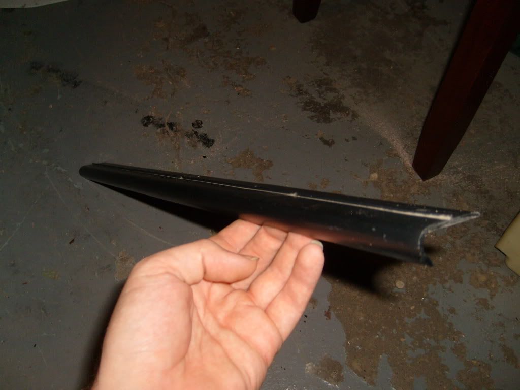

Do me a favor. Remove that top bracket & take a picture of it for me.

This bracket seems to be the same thats on my MK 2 cabinet. And I don't think the neighbors would like the sound of "Get over here!!" echoing through the neighborhood with that Peavey. :)
Ok. That's looks right.
Reason I ask was, That's where I found my front glass bracket.
my "Midway" does not get cut off by the marquee top bracket. it's close but there is no covering of the letters. looks like you also can't see your copywrite info/date/mfg mark... strange
