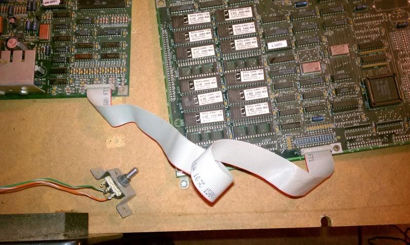

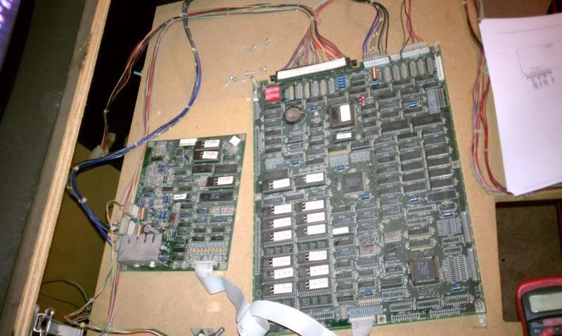

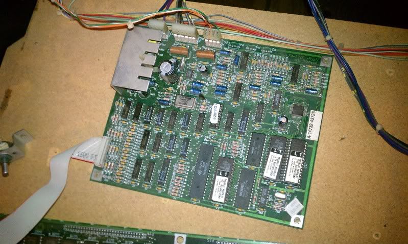

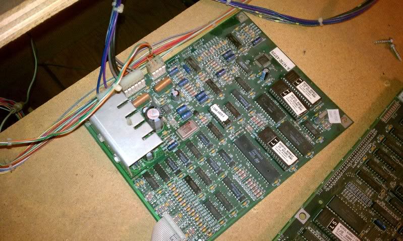

So i found that there IS power going from the CPU board TO the sound board, and all the grounds check out. I check the speaker and altho she looks rough, I tested with a 9V battery and it worked. My UE 13 never lights up on the ROM boot up screen. (U13 is on the sound board) I got rid of the "IRQ not detected" by I think plugging in the wiring harness (looked to be unplugged when I got it home and apart.
NOW, there are 3 big L1 chips on the sound board and 1 little chip that can be removed (sorry I don't know the proper lingo!! ) and the only chip that creates heat is the little one, the 3 larger chips stay cold. All caps look good.

i can't tell from the pics but is the red wire of the ribbon cable at pin 1 on the sound board? (it doesn't say pin 1, it actually says 2) basicly red side of wire should be at (2) instead of 16 or w/e on both boards.
other than that everything looks in order. what were the voltages on the soundboard when you tested?
i just looked at my nba jam te and it looks the same so it's not your ribbon cable (unless it's bad).
also check the resistance on that speaker (even tho it passed the 9v test it might be creating a high resistance?)
I don't own this game but i own nba jam, nba jam TE, and UMK3 so my help is limited, i don't know about the u13 sorry.

Thanks for the help tho! The voltage was 11.7 and 4.7. I figured that was close enough to 12v and 5v.
I will double check the ribbon cable tonight, maybe i should buy a new one?
yup there's a knob on there (the power switcher) to adust it i'd unplug the jamma connector from the game and power it up to test with volt meter, rather than adjust voltage with the game plugged in and on.
Welp, Played with the power switcher and got it up to 5.01 volts, the 12V went up to 12.18. Still no sound tho...
i booted up my nba jam today and noticed my u13 doesn't light up either, but my sound works. so that answers that question for you.
maybe check the resistance on the volume pot? that would rule out all the basics as long as you've tested voltage of the wires in the molex at the sound board including -5v
beyond that i'm stumped as i don't own mk1 yet.
also just for the heck of it, do you have another board you can throw in just to see if the speakers and wiring work. (you might have already tried this and i over looked it). also there's only 1 volume pot in the machine right? (sometimes there's one by the coin door (not sure about in mk machines tho).
