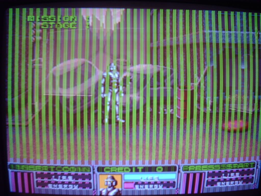

The screen image was actually taken from a mirror I was using to adjust the monitor. I have nothing to compare against, but this board seems pretty sensitive to sync. Nice eye for detail there!
I thought a mirror might be involved but wasn't sure. :)
I have done board swaps where I had to adjust the monitor for each board due to sync issues. I don't know which to blame - monitor or board. I always blamed the monitor since it had to be adjusted but maybe the signal from the board isn't totally in spec either.

So I wired up a service switch and the corruption was so bad I could not even step through it properly. I also don't think this is a 100% JAMMA pinout as I can only user player 2 in the game. During this I noticed the screen changed ever so slightly when I was moving the board around. Uh oh. After tapping around the board I isolated and found my connection issue, a big fat surface mounted custom chip. Surface mount soldering is not the most fun soldering work for me.
I went through several rounds of work and the board improved a bit each time. A work in progress picture:

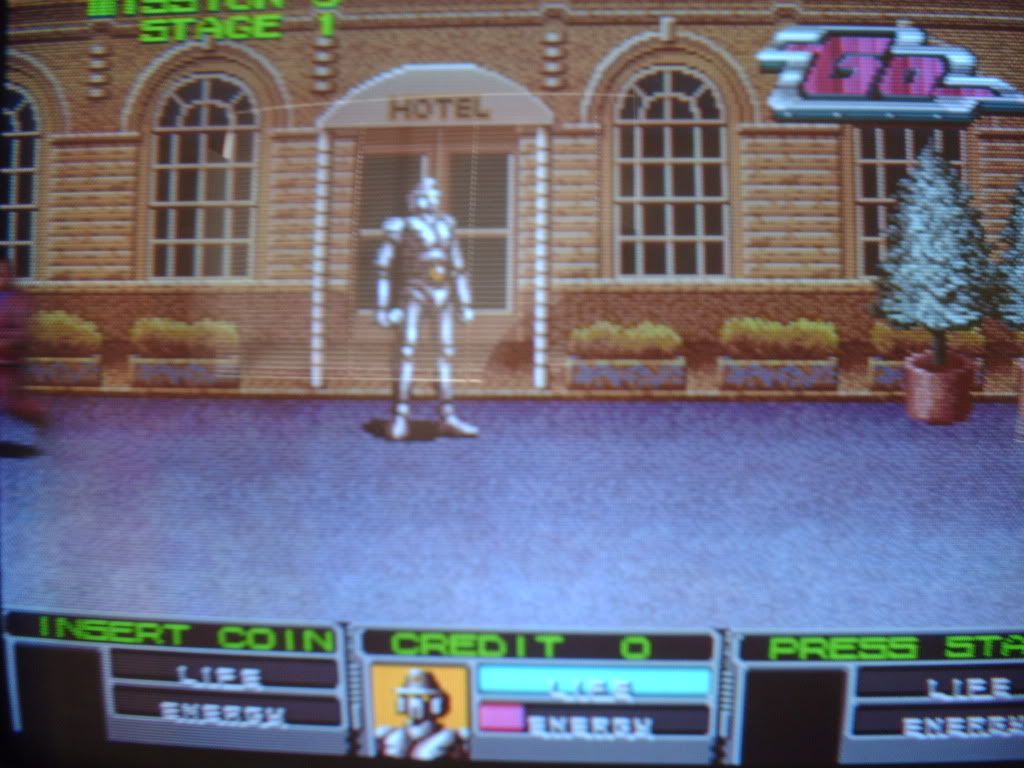

After five rounds of adding solder to pins I had lost a pad but everything metered out okay. I had an almost perfect game aside from some slight corruption. After my final round, all appears to be be okay! The only thing this board needs now are the missing socketed PALS!!!!!
I wanted to close out this thread with the recent arrival of a scrap bottom Clutch Hitter board that had the necessary parts to make this run on it's own (I had been stealing parts from my Shadow Dancer PCB). Thanks channelmanic! I also loaded up a set of standard 2 player Japan EPROMS that make this function properly in any vanilla 2 player, 8-way, 3 button cab. Fun game from the same dev team that did Shinobi, Altered Beast, and Golden Axe; classic Sega stuff.

The Alien Storm set I burned was proof that the board was finally repaired and operational. Thanks to forum member dbstallman who was able to answer a part number question that was the final piece of the puzzle here. My stumbling block was the Intel D8751H copy protection CPU at location IC4. Without this chip the game will not run at all, even with the correct de-suicided code. After I got the part number, I did some research and found my chip burner could actually write the chip! A quick BIN on ebay and a few days later, and I now have a working game.
