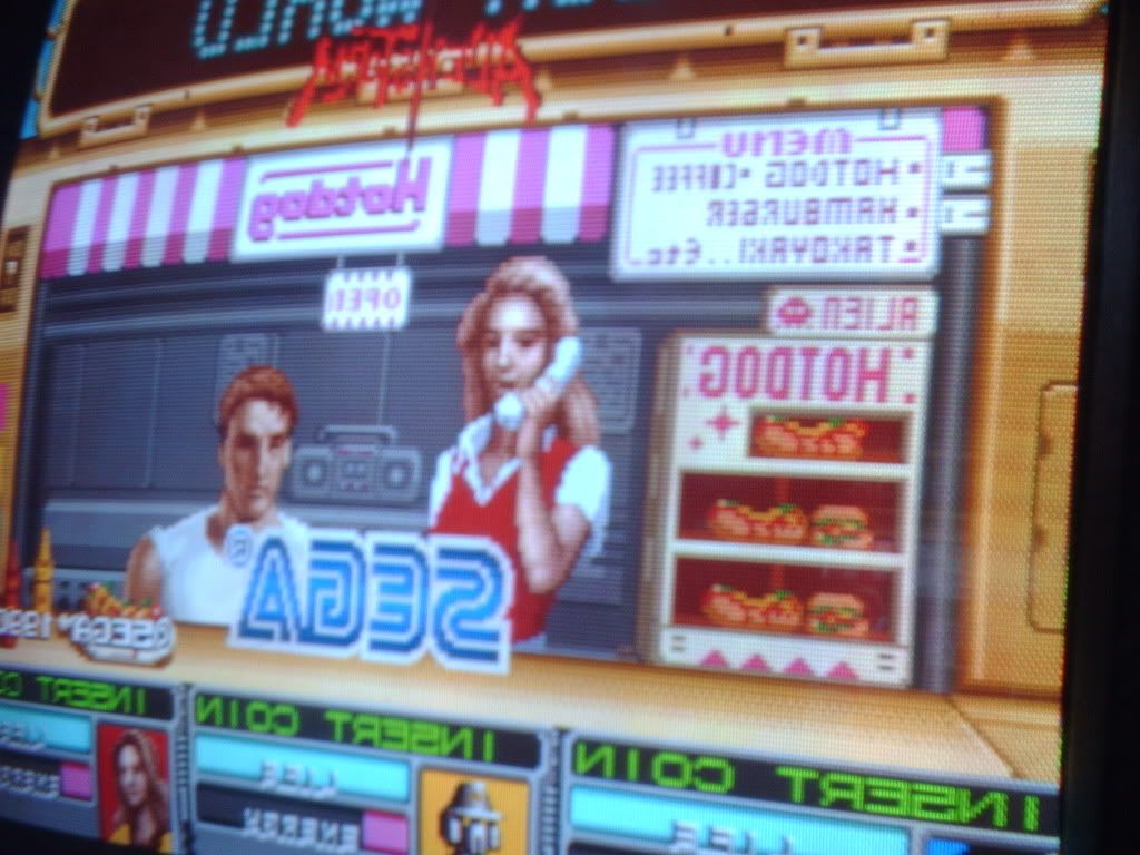

I programmed the Moonwalker set that I made and....I now have a slight change of plan....
It seems like Moonwalker is going to want that extra CPU...or my set was wrong (which I doubt). This was not a real setback though, take a look:
Yes, I'll be running Alien Storm on this board, which is fine by me, and a bit less creepy :)
