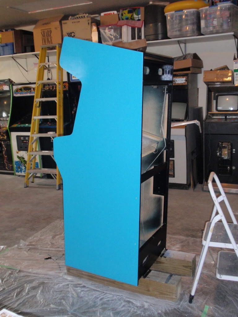

Well it's taken me a while to get to this one. Since I have finally finished the endless bondoing and sanding and have graduated to paint, I thought I would post progress pics. I have a long way to go, but I was so happy when I finally saw paint on the cab I figured it was time to snap pics and start the thread.
Before. The bondoing was intense, as all 4 bottom corners had to be rebuilt. You can see the nice black band someone painted at the bottom.

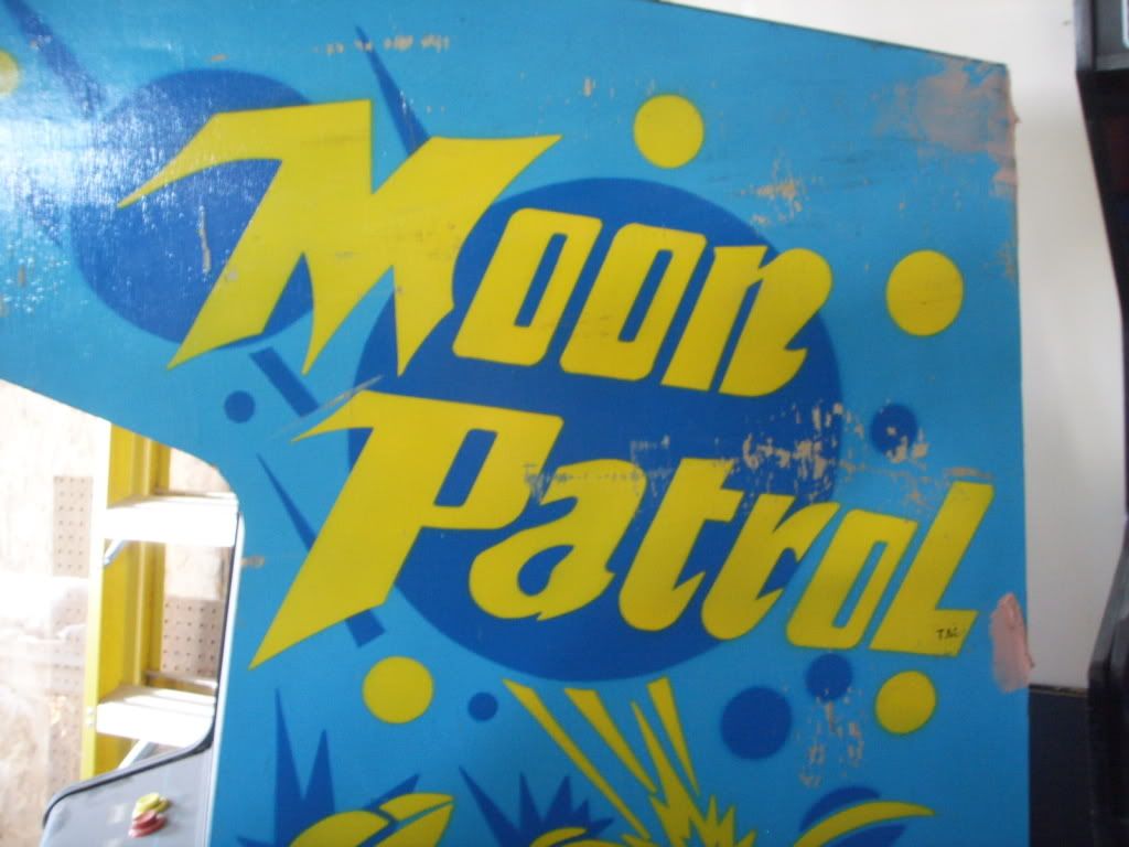

The graphic looks OK from a distance, but the paint was flaking off horribly:

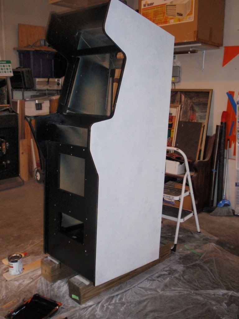

Corners rebuilt, cabinet sanded. Time for primer and first coat of black:

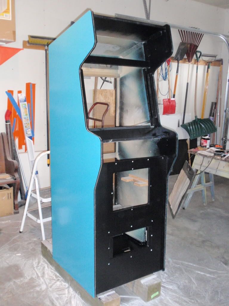

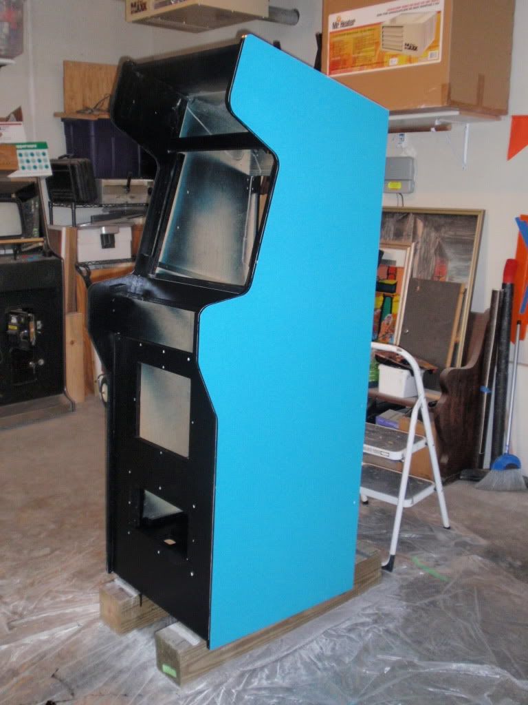

First coat of 'Infinity Pool Blue' (color matched by Sherwin-Williams in their 'All Surface Oil Enamel'):
Wow those corners are a super sharp 90, are they not? Imagine for a minute that you had a nice open air surface to work, but it was a leaky carport, so at night you had to move the cab up a ramp and into a house after your bondo work. Imagine it was a tall Atari cab, and that it was inevitable that you'd bump the corners and fuck up your hard work. That's my situation, and it has caused me to not be so worried about how perfect my corners are. I'd love perfect corners, but it's really hard to keep them perfect when you have to move the cabinet daily by yourself.

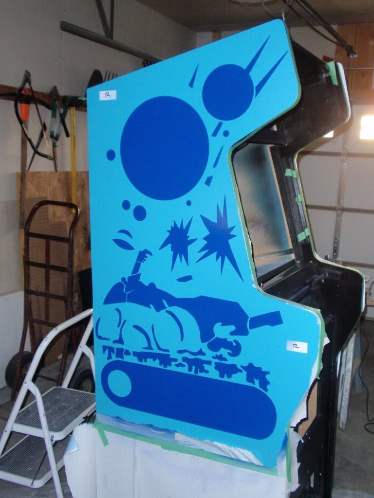

One side of blue done. This was my favorite stencil reveal to date. What awesome artwork! Now to get the other side done and start the yellow. Man I love Moon Patrol.
