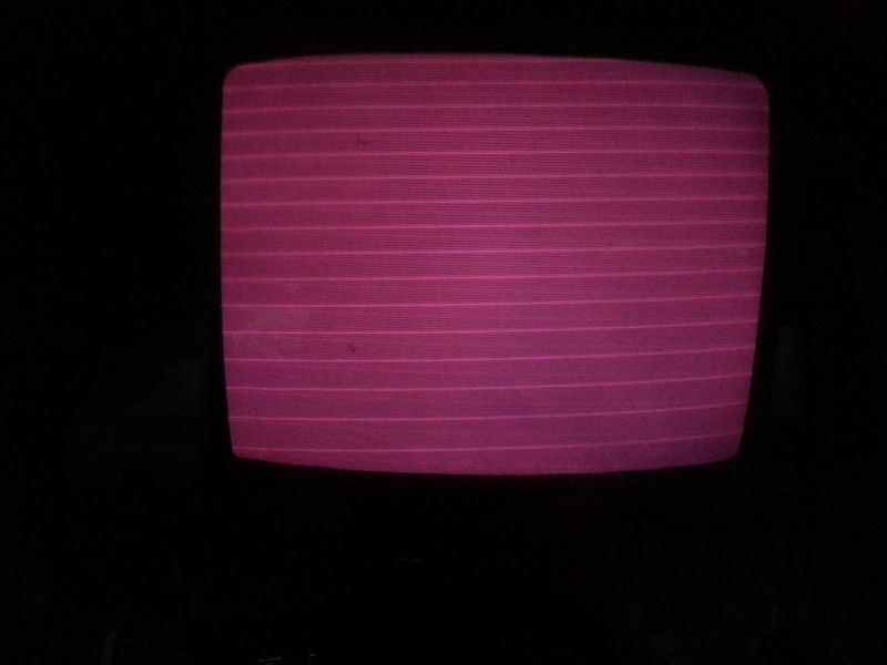

Just wanted to get some opinions on what the issue could be. This monitor came in an out run cab I recently purchased. Seller said one day it just stopped working. After I turned it on this morning I ended up with this:

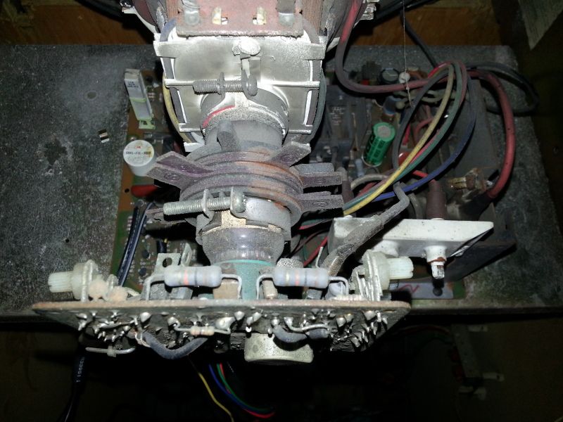

Photos of the chassis:
Any idea on what it could be? I noticed the two sync wires at the chassis are joined into one coming from the harness. Not sure if this has something to do it.

the lines are retrace lines.(coarse brightness on flyback is a little too high) but is is showing some signs of life!!!
DO you hear the game play?? Like can you coin it up and drive blind?
If not, your game pcb isnt firing up, monitor is probably ok,. Check power supply voltages and connectors at filter board.
If it plays blind.. well then thats odd. I might be wrong but that appears to be a nanao monitor and not alot of peeople mess with those. If it plays blind and youve checked the narness between the pcbs and the monitor, next step would be to back it up to another cabinet and swap video wires to see if its still something else int he game or the monitor.
If it plays blind.. well then thats odd. I might be wrong but that appears to be a nanao monitor and not alot of peeople mess with those. If it plays blind and youve checked the harness between the pcbs and the monitor, next step would be to back it up to another cabinet and swap video wires to see if its still something else in the game or the monitor..
Judging by the corrosion i see on the monitor frame that thing sat in a damp place for a long time. WOuld be best to go through all the connectors and see if you can find any corroded ones.

Tested the monitor this morning on my Galaga cabinet and get the exact same result as photo one at the top of this post. Starts with a grey screen followed by a pink screen with all sorts of lines. At least I narrowed the problem down to the monitor.
