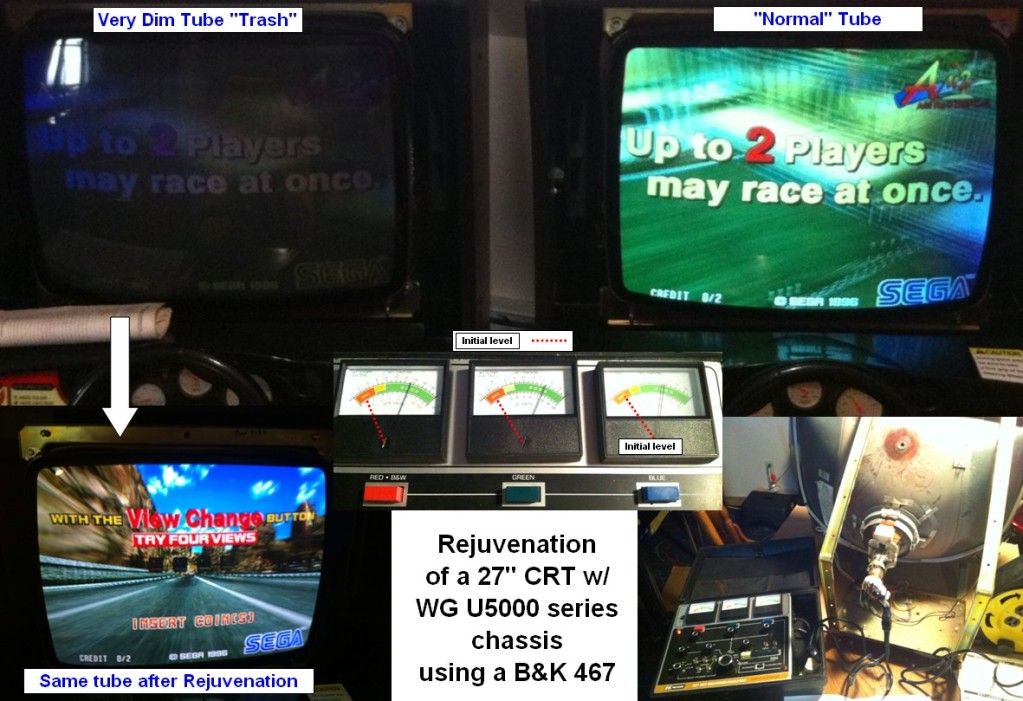

I had just the tube to try a first rejuvenation on, a WG 27" medium res with a U5000 chassis.
Sadly, I parted the game it came from because it was a dead tube, just had not gotten around to disposing of the tube itself. ahh well... hindsight again.

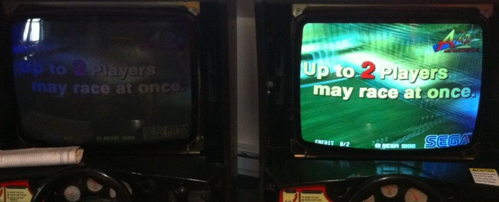

Both of these monitors should look the same, the tube on the left was as bright as it could get!!
So I quickly made up a CR23 adaptor from a G07 broken neck board and plugged everything in.
I actually read the instructions a couple times, lots of buttons and dials, but pretty easy actually.

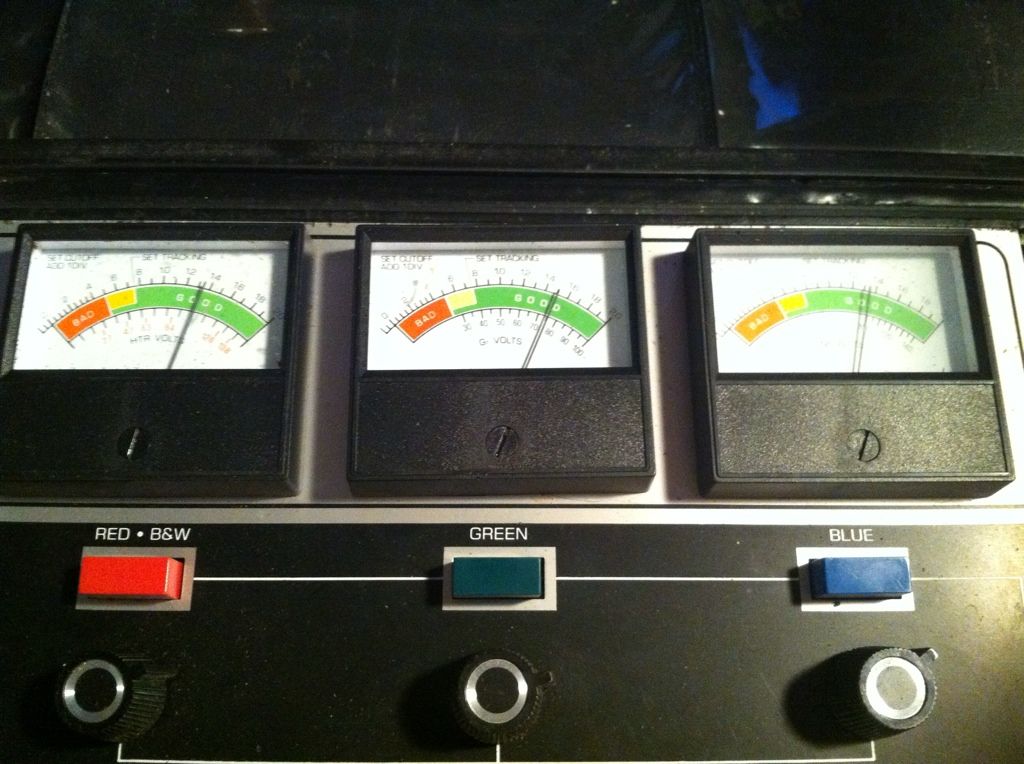

So, I set up the 467's voltages and began the testing.
- None of the color guns are above halfway through the red zones.
- G1-K short light is blinking on and off..... so I perform the "Remove shorts" function.
(basically your discharging a capacitor in hopes of burning out the short)
- FAILED the tracking, lifetime, and Focus OK tests....
- So I perform a low energy "cleaning" cycle... no help....
- Time to bring the big guns and I set the restore mode to rejuvenate!
Now, the rejuvenate cycle does carry a risk... but the tube is dead anyway, so I proceed to run the cycle on the red gun only... flares and flashes ensue from the neck during the 2-3 second process!! ughh...
I quickly returned to the test mode and let everything settle... nothing yet....
Reading the instructions, I jump back to re-adjust the gun cutoffs and then.... life, the heartbeat is back so to speak.... the needles settle into green, uneven as yet.
So I go back to the restore mode on the clean setting and hit each gun....
Going back to the test mode and everything lines up....
Check tracking -- good, check lifespan -- good, check focus circuit --- good...
WOW... that was cool... the 467 is saying the tube is good, with life left yet.
Well, proof is in the pudding, so I installed a U5000 chassis and fired it up...
COLOR!!!
So, if your into monitor repair, don't underestimate the rejuvenator.
It does a lot more than just "rejuvenating" a tube, it's your eyes into the health of the most important part of your monitor, THE TUBE! :D
To sum it up in one picture:
Make sure you scratch out the "bad tube" that is wrote on the frame. ;)

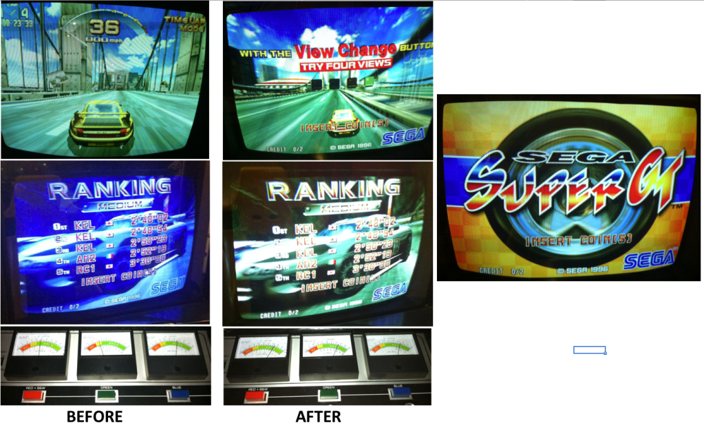

Here is another example... a blue tint was plaguing me, I just couldn't seem to balance it using the neck board adjustments.
It was subtle, the "Ranking" picture showing the blue glow was captured more by the camera than what the eye saw IMO.
The top picture is more of just how subtle the color was most of the time.
I had just about convinced myself the blue tone was just the way it was supposed to be.
I had the brightness and contrast down as the blue was more noticeable with a bright setting.
Check out the rejuvenator meters!! Blue is the strongest gun...
In the after pictures, I have not yet checked neck board settings, but the guns came out very evenly good.
Keep in mind that the ONLY change in the before/after pictures shown is the rejuvenation process! :D

I never even removed the blue tinted one to do the rejuv, just discharged it and pulled the neckboard.
Process completed right inside the machine! :D
