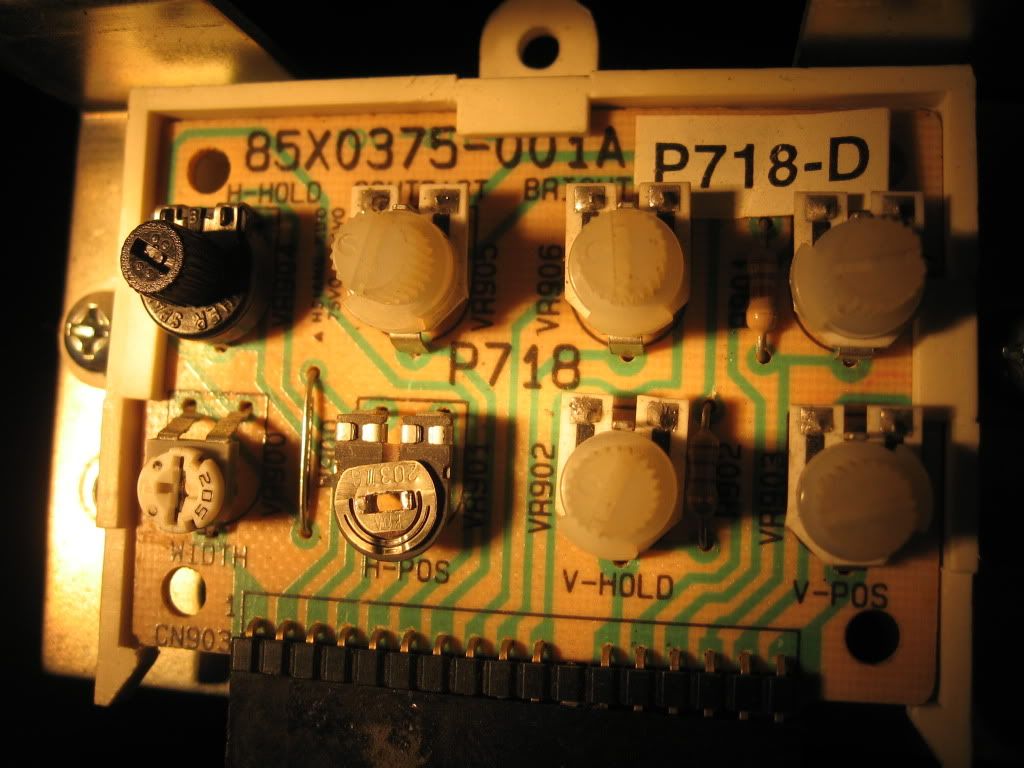

ok the only two adjustment pods were v and h sync pods wich is odd because you can also adjust that stuff on that separate control pcb.
This is the only other PCB that i can see connected to the monitors main board.
that's the remote adjustment PCB.

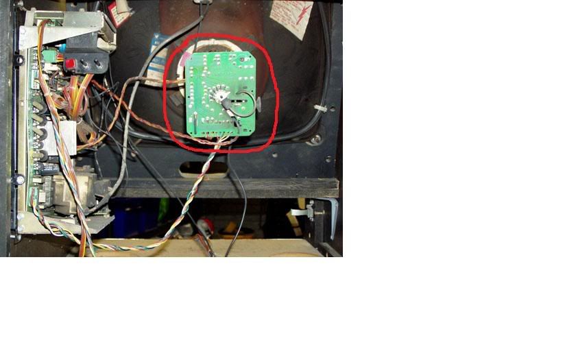

the neck board is the PCB that's attached on the very end of the thin neck of the glass tube (hence "neck board".)
i circled it in this picture... not the same CRT but the neckboards are all in the same location.

i adjusted the pod all the way on the left (B Bias) from end to end and it didnt turn the blue up at all, all it did is turn the screen green so i took it back to where it was. then i tried playing with the rest of the pods and they would turn the color i was adjusting off from one side to green if i turned it all the way. i set them all back to their default before i messed with them. so i guess i just gotta take out the pcb and redo all the solder. is this right?

See those parts with the big pieces of metal attached to them just below those color pots you were adjusting? Those are the color drive transistors. Look at the other side of the neckboard while wiggling them with your fingers. if you see anything moving directly opposite of the part you're wiggling, that may be why you have no blue...
well i wiggled them thoroughly and i didn't see any cold solder joints or anything moving on the back of the neck board. are those pieces of metal supposed to be heat syncs?
Yes. Okay, then the next step is to measure voltage while the monitor is on. The red, green, and blue signals come to the neckboard by wires. Measure the DC voltage at each wire to see if all three make it that far. If you have voltage for red and green, but not blue, then the problem isn't on the neckboard.....
ok cool ill have to do that after i get home from work! ill also get a picture of the back of the neck board to see if im measuring the right spots.
