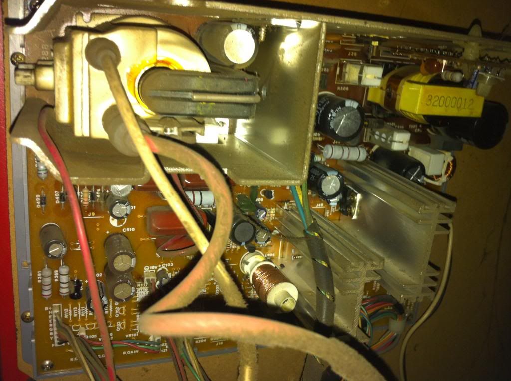

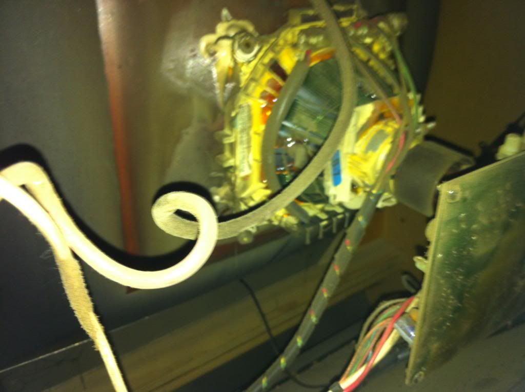

Hey guys, was playing point blank last night with my son when all of a sudden the machine died, i looked around a little inside (im no expert) and noticed the main fuse was blown, i replaced the fuse and switched the cabinet back on, everything powered up except the monitor. I can hear the game etc but had no power at all in monitor, i opened the back and checked monitor fuses and they are all intact, i noticed there was no orange glow at all in the neck.
So a monitor fault has triggered the main fuse?
Is it my chassis? or something else?
Would appreciate any advice or info so i know what my next step should be.
we need to know what monitor you have.
if you do not know take some pics of the monitor chassis.
Peace
Buffett
Very tight and hard to get into area, i i reached in and took pictures with my iphone. do these pics help?
