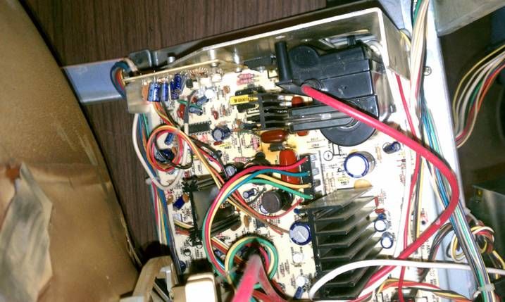

I cannot, for the life of me, figure out what monitor this is. Thanks in advance.
Its a NeoTec something or other. Look on the back of the neck board cover for a sticker. Its probably a 2701 or 2702 form the looks of things.

Whats the symptom on the monitor?
No high voltage or neck glow. Very quite clicking coming from chassis upon powerup.
Hv Cap
I should have guessed..
You are getting B+ but its loaded down..
Suspect is the HV polyester cap..
Next to the Pin amp black heatsink and the damper diode
the dark looking brown HV cap in picture.
looks like and from experience it has a split in it..
If original caps you need a cap kit too.
also check the HOT if still good,it maybe ok.
Alright, thanks guys. Do you know where I can find a cap kit for it?
It is a NeoTec 2701. Thanks guys, that is why I ask you. Now I need to track down that C423 cap.
