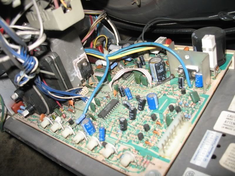

Its a 19" Med Res WG , but what model is it ?
How much are one of these worth with the burn in that it has ?
It works good but the picture shakes a little . Isn't that usually just a cap kit ?
Looks like a Wells-Gardner K7000 to me. 19", I think those were mostly (if not all) standard res. Why do you think it's med. res? Also, the screen burn isn't that bad, depending on what game you put it in, you may not even see it. And as far as your monitor shake, could be out of adjustment, could be the hold pot is bad/dirty/poor contact, or it could need a cap kit.
The only reason I know its a Med Res is because I just pulled it out of a Narc cab , haha . Yeah it looks just like a standard res K7000 to me too , but it is a Med Res .
The colors look good so maybe it is the hold pot and not the caps . But it is from 1988 so it probably could use a cap kit any ways .
A standard K7000 cap kit will work just fine on that monitor. I think the model is k7915 or something like that.

I have had a couple med res K7000 series monitors. The daughter card on top of the flyback housing seems to be the visual give-away. A standard K7000 cap kit will have all caps except any on that daughter card. Just order it seperately or pick it up at Radio Shack...
