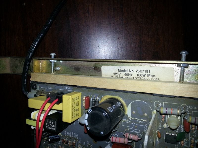

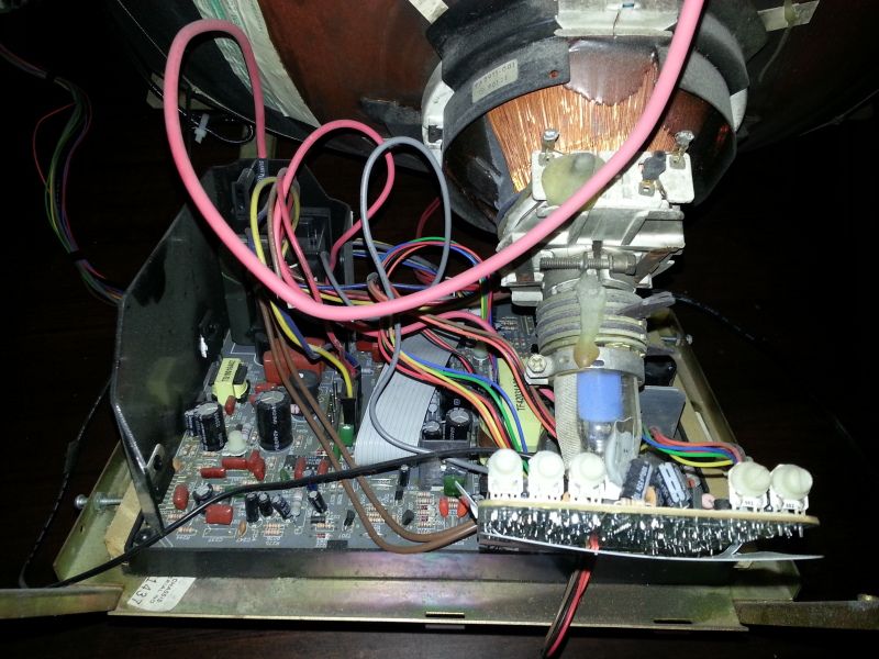

Hey guys,
Need some help please.
I believe the fly back on my SF2 monitor is starting to go. When I pulled it this afternoon, I found this in the side of the chassis:
Jen Schinn
Model 329
But on the frame of the monitor, it states Wells Garder 25K7191
My question is could I use a K7000 chassis on it? I really have no knowledge of these JS chassis nor do I know where to buy replacement parts.
Any help would be appreciated.
Thanks in advance.
Here's a few photos of the monitor / chassis.
yea someone put a POS universal chassis on the tube.
get the yoke readings to be sure it is a K7000 yoke.
but from the way it looks it is a K7000 yoke.
Peace
Buffett
Thanks Buffett, really appreciate the help. I have a 7000 chassis and thought I was on the right track but just wanted to make sure :)
