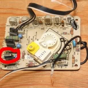

What does a red drive transistor look like on a 19" WG k7915 medium res? Im not familiar with monitors. Its on the neckboard though?
Here's a shot of one of my neckboards, with one of the transistors circled in red. There's 3 of these drive transistors on the neckboard, and you can usually tell which one goes to which color by reading the silk screen printing on the back of the neck board.
So i looked over those three transistors on the neckboard and nothing is noticeably wrong with them. The red pot on the neckboard is not working either. I resoldered some components that looked like cold solders but to no noticable change. Guess Ill discharge the anode and take a look at the board. For the record, and besides the anode, where should you NOT touch the monitor while its on or off?

all three of the colors (RGB) were giving me a reading right around 5 volts where they connect to the monitor chassis and all three of the transistors were giving me the same reading. Two of the legs were reading 15 voltsDC and the middle one was reading 125 vdc
im sorry but i vote tube.
Heres how to prove it. Youve already checked red input, youve already checked red output at the transistor. logic follows that its either a neck socket issue or tube issue.
The fact you see a little red on top of the green test screen DOES NOT mean that the red gun is working.
If the tube is magnatized a little, the red phospor on the front of the tube will attract the beam from the blue and green guns..
degauss the hell out of this thing and recheck. does the tube now show perfect green and blue but no absoultely no red? Then you need a tube.
ok, so I dont have a degaussing coil but I did have some neodynium magnets I used to test the monitor. on the red test screen, waving the magnets over the screen clearly shows that all three colors are showing up in a rainbow like effect where the text is. If the red is showing up when I do that, then the tube is working correctly right? at that point Its gotta be somewhere on the board. I have used an ohm meter on the pots so that may be the place to check next...
