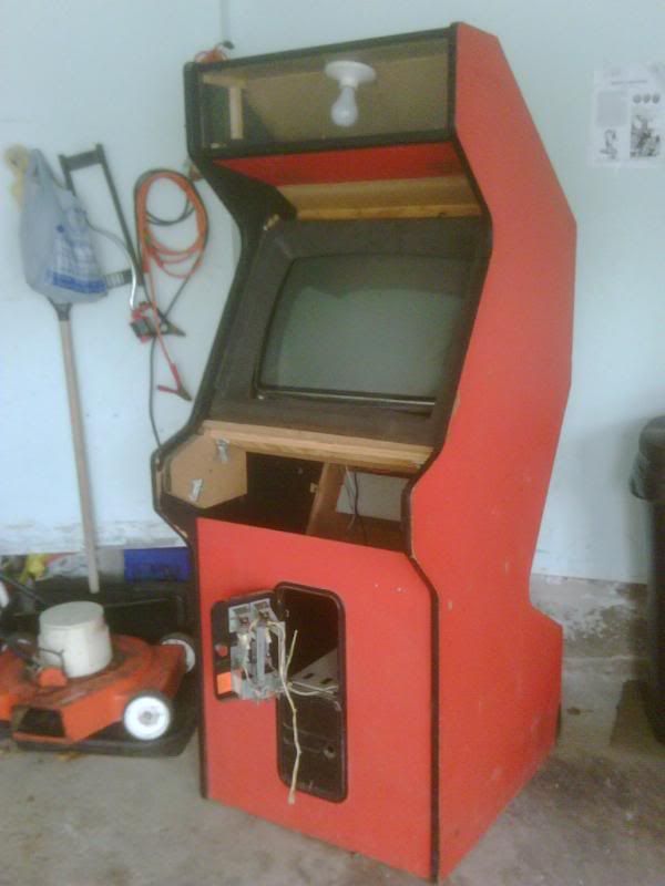

Hey guys,
I am looking for a monitor bezel for the following cabinet. Not sure if it originally came with a plastic bezel or a wooden one.
Please pm me if you can help and kindly provide a price with shipping to Canada. L4G 1S1
Cheers
looks like a home built cab, but im not shure.i like the home lighting system that was installed in it.. (LOL). but you can goto your local hardware store (lowes) (home depo) and they can cut plexi glass to any measurements, hopfully that helps you some!
That's a Z-back cab. looks like it already has a black monitor bezel installed. Why do you need another?
The monitor beel shown on this pic doesnt quite fit right. I don;t know if these bezels are universal or cabinet specific and also, does the artwork around the bezel just sit on top of the plastic shroud and finishes withthe plexy on top? I was hoping someone with this style cab coudl chyme in and shed some light.
My current Dynamo HS-2 cab has a cardboard shround around the monitor, followed by an mdf board where the game bezel sits on and is finished by the plexi. I was wondering if the Z cabs have the same setup or not.
Can't you just move the bezel up? It looks like you can.
bezel
That looks like a dynamo angle 25 inch cabinet. you could turn the monitor in those by removing 4 screws and pulling out the monitor and turning it and the wood piece it was attach to 90 degrees and now you had a verticle or horizontal cabinet.
In front snug around the tube was another piece of wood and in front of that was a paper/cardboard bezel. what you have is wrong. look for a paper bezel from somebody.
That's what I figured but just wanted confirmation. The paper bezel I have, I just need the piece of wood. I'll try to get it cut locally as I dont have the tools to do it.
