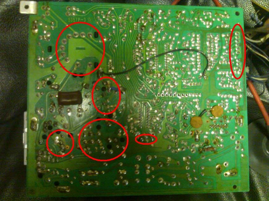

Monitor acts like it shuts off and on real quick?
I've circled the most common areas for bad solder on the K7000. The small circle in the middle is probably the biggest culprit. If any pad moves even the tiniest amount when reflowing, then assume that it is no longer connected to the trace, and use either a clipped component leg or piece of insulated wire to connect it to the next point on the trace:
Since your symptom looks like a vertical deflection/collapse problem I added a couple spots to check the solder joints on.
The vertical IC and the yoke header pins.

I didn't realize there were more posts in this thread, sorry about that.
I still have the issue and here is what I have done.
Gone over the entire pcb several times sucking solder checking and putting new solder on bad area.
Cap Kit
New Fly Back
New resistors at 91, 92 and 93
Replaced IC3
The problem seems more spread out now, but still there.
Now when you say check power supply, you mean my switcher could be causing the issue? I didn't even think it could be that. I will swap that out asap.
Ed
Well, changed power supplies (switcher) with no effect. Same issue.
I put it on the rejuventator just to check for leakage and do a clean and it seemed to make it better, but the problem is still there so I don't really know. It's so random.
It seemed to happen less frequently when I adjusted all of the color controls down and set them each at 1/2 a turn. But again, I have no idea if it helped or not.

dont know if it pertains or not but unsolder r101 check it, check the traces, then reinstall it. ( cant remember if thos ends up on the horiz or the vert on this monitor)
but like i said unsolder AND CHECK THE TRACE UNCERNEATH of r101. R101 and other components in that same area tend to cook bad. SOmetimes r101 solder will look fine, but once you unsolder it, you find the trace underneath has tarnished completly black.
but worth a check man.

how do the traces/solder pads look?any cracks or black tarnished traces?
the solder joints for r101 look like they need redone and you do have r101 there it looks like its missing from the bottom pic. also all the traces-pads by ic3 look to be bad or missing check them for continuity. and run some jumpers to make shure.

Yeah, I still had my r101 removed for testing when I took the picture.
The IC3 solders are all new, and look bad in the picture. I went ahead and tested for continuity as well, all checks out ok.
OK, as suggested I monitored voltage on Pin 6 of IC3.
It's steady at about 53.9v. When the monitor collapses I see it spike to 54.9-55.5.
Does that help at all?
