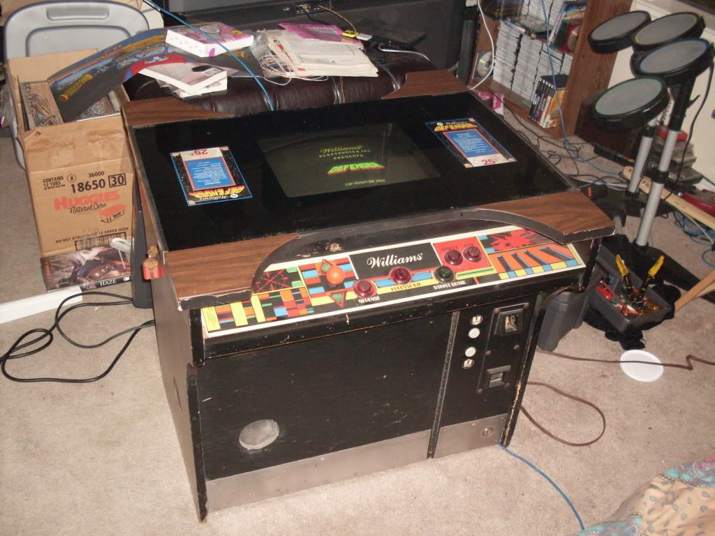

Okay, that's done. I had bought a working later-series Defender CPU (for the CT) a while back as I knew the one I had was too acid-damaged to be fixed easily. It had already had the lithium battery upgrade done on this working one, so that was good. Dug around in one of my Williams ROM board boxes and found two Defender ROM boards. Already had a widget, power supply, and sound board in the CT.
So, I put everything in and discover my first problem - the power switch was missing. No problem, as I have a couple new power switches in a drawer, but I had to manufacture a mounting plate where the big hole was on the bottom. Okay, that problem was solved.
I go to plug it in and discover my next problem - the end of the power cord was missing. Wonderful. I have no new ends, so I have to go out to Home Depot and pick up a couple (to have an extra), and get some paint while I'm at it. Come home and put it on and power it up.
Great - ROM 4 failure. I swap in the other ROM 4 from the other board and same error. Try the other board and it has bigger problems as it won't even come up. Could both ROM 4's be bad? At this point it was late Friday night and I couldn't do anything about it until the next morning.
Saturday - I don't have a ROM burner, so I called up the 2nd buddy (who has a Defender upright) and went over to test in his machine. Turns out it WAS two bad ROM 4's. His ROM 4 worked just fine. Got his brother to burn me a new one, and went back and all tests pass.
Except - it seems all the months I've had the board without using it has caused the battery to go dead. And I had no CR2032's, either. So back out to Walgreen's to grab a couple. Put one in, and I had a working game! Set the game on free play and sat down to try a few games.
Except - the screen didn't flip during 2-player games. Now, I knew from reading posts here that this was a jumper issue on the widget. Obviously, the widget in there wasn't indigenous to the game. Pulled out my manual, then removed jumper W1 on the widget. Everything was now working perfectly.
Pulled the power supply to make sure there were no cold solder joints (common) and found some to fix. Afterwards, everything was perfect. Just needed to do some cosmetics and it was ready for delivery. One of the control panel plastic overlays was cracked, but I had bought a pair of Defender CT control panels a while back from Chris25810 (one cracked and one nice) for that purpose, so that was a fairly painless replacment.
So - from a pile of scattered parts and an empty, dusty cab to a nice working machine in two days - all because someone was waving cash in my face. I need more motivation like that.
Now the guy is asking when I'm going to have my Area 51 Site 4 done. I told him, "Someday..."
Here's a pic of the working machine (and the living room I messed up while working on this and watching college football) before I did the CP swap and clean up/touch up. I forgot to take picture of the finished game...
