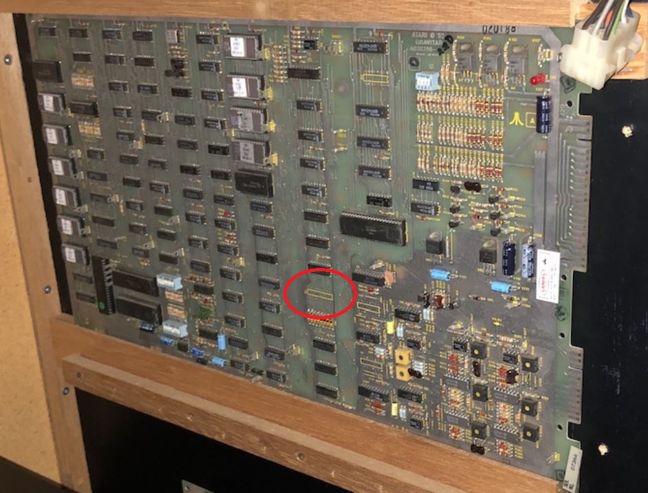

You know, some days I think it's just time to hang up the Hakko 🤦‍♂️. With everyone's suggestions to look at the DAC08 I was about to unsolder it to only find one row away…..this! LS273
How the F I missed this is beyond me. Uggg…
Regardless, now everything is up and running great. Much thanks guys for all the advice.

Note that the replacement for that MUST be an LS273. I use HCT logic to replace most other chips on these (which are cheaper, and use less power). And in most cases they work fine. However this is one place where it won't, and it must be LS.
