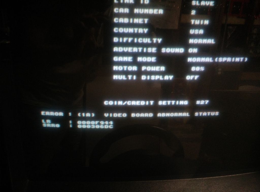

One of my Sega Super GT twins started giving a video error on startup and will not boot past it.
Error: (1A) Video Board Abnormal Status
It worked fine last weekend. I pulled the board stack out and it was filthy. I pulled the stack apart, cleaned all the boards, made sure all the roms were seated and re-assembled but I'm still receiving that same error. I plan on swapping boards between my working and nonworking side to narrow down the problem but thought I would ask here first.

Thanks for the reply. It's definitely not a board connection issue. The game started giving this error before anything was messed with. I completely disassembled the board stack, cleaned all the boards and connectors, reassembled everything making sure all the connections were tight and then booted it back up to the same exact error message.
I just swapped the entire cage into the working side and it gives the same error so it's not cabinet wiring.

Its just a generic error that tells you something crashed system. Could be leaky super cap on CPU bd corroded pcb, could be bad QFP RAM over by CPU on CPU Bd. Could be bad stack connectors between pcbs. Swap pcbs to confirm and I can direct you closer.

So it looks like both the video boards are the problem. I swapped the video board from the Virtua Striker I just received onto each of my Super GT board stacks and they fired right up.

All Model 3 cages came with dual fans on sides of cages. They were mainly to keep the Power PC processor cool on CPU Bd. Its rare to ever get heat damage to Video Bd. And other pcbs in stack will not cause damage to Video Bds. Ok unless the CPU bd had wacked stack connectors and mangled the mating connector on Video Bds but that really never happens. What will take out pcbs is voltage. You should have 5.10 and 3.30vdc at CN13 of Flt Bd on cage. If so and power is stable, you just got a bad Video Bd. I have fixed hundreds... ok maybe closer to a thousand Video Bds on Model 3 so it should be no biggie to fix. Also, its rare for a Video Bd to die. It more usually will have graphics issues and show bad RAM or boundary errors. You can send any of these in if you like.
