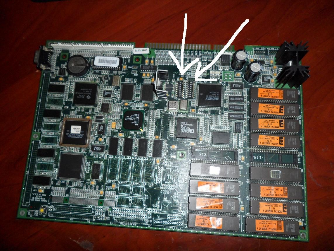

I was working on someone's monitor last night on their MK4 arcade and I noticed that the game would not go into free play.... I replaced the battery so the date and time would save and all that.. But once I selected free play in the setup and exit setup it goes into the game but free play isn't activated... I noticed that there seem to be no physical dip switches on the PCB (unless I'm blind?) and all of the roms check out good in the boot sequence... Has anyone run across this problem?
The dips are here...
Unless its a bootleg board its got to have DIPs somewhere. You need to change the DIPs to CMOS coinage and then freeplay will stay enabled.
