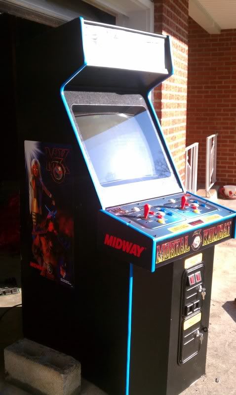

Awesome, thanks guys, as far as size, is 3/4 what I want to get for it? (its been quite a while since I've ordered)
I was looking at this cab, and the black looks plain and boring, I know red is the standard with 1 and 2, but I was thinking light blue would pop really well and go good with the cpo.....thoughts?
correct 3/4" red t-molding. i recently ordered 80' of red and 50' of black from Gamemolding.com very happy with it and the price. i'm a purist so i say go red/black (imo red) but it's your game feel free to put whatever color you want on it :D
Finally got her done! Heres a couple pics of how it turned out. Not too bad for a conversion..
Cant seem to get the marquee bulb to come on however, I replaced the bulb and starter, but still no-go...
Ballast is the only thing left to change. I'd get a new fixture from wal mart for 6 bucks unless you have any parts fixtures to pull a ballast off of.
i'd check for voltage at the wiring first. if there's voltage i would then source a replacement for the whole unit. either the wally world, other big box store, or another used working unit.
Yeah, I replaced the whole thing, still nothing, I suspect something in the wiring perhaps...
