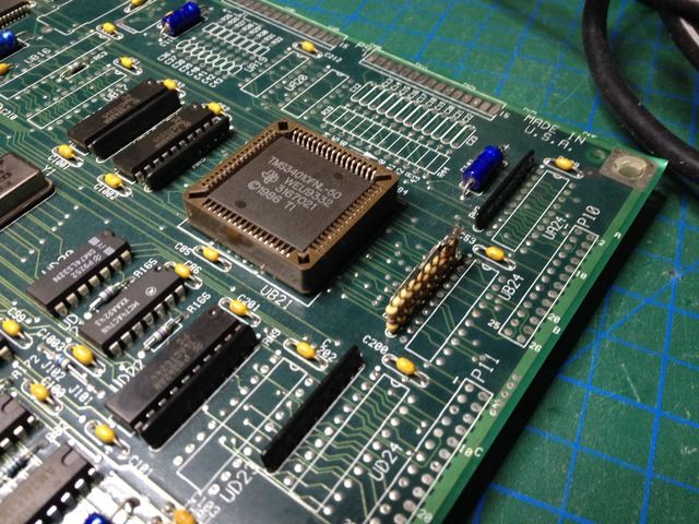

Hi, as the title summarizes my problem, my MK1 PCB won't boot until I manually press the tact button on the PCB.
Is this normal?
Nevermind, I found what the problem was...
I traced back the RESET line to the CPU (TMS34010) with the help of the T-Unit schematics (Page 47 of the manual)
https://www.arcade-museum.com/manua...mbat_1_Kit_TUnit_CPU_1643275101B_Feb_1993.pdf

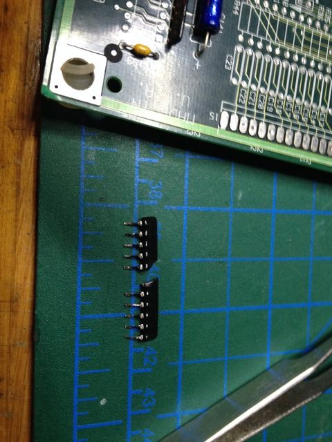

I noticed that the resistor network, RN6 specifically, which was pulling up a few control lines to the CPU (including /RESET line as well), infact has a crack in the middle :)
When I desoldered it, it just crumbled...
Then I made a guerilla style resistor network out of 4.7K resistors...
Now my MK1 boots automatically when I power it on...
