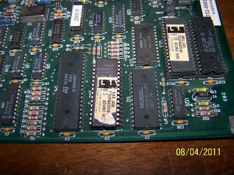

have you gotten anywhere with this? i just replaced my missing Y1 crystal with a shorty one (shouldn't ever be an issue again). I have yet to test it but tomorrow it's one of the first things on my list here's a pic :D
This is just a spare board as i mentioned before, and the U3 chip looks like someone stepped on it but i think it was still coming up green on the test menu if i remember correctly.

Just an update, fixing my missing Y1 xtal fixed the repeated 7 bong issue, i now have a fully working spare sound board :D
Awesome. I was looking at the boards a little while ago and lo and behold the original board that I had that was not working and one of the three I got yesterday were missing that crystal. I took them off the other boards and put them on the boards that were missing it. The original worked right off the bat. The other board had the R89 resistor getting very hot. The cap right beside it was bad so I replaced it and that board is working now too. So I have 2 out of 4 bad boards working now. I am going to troubleshoot the other boards after I get some replacement crystals to put back on there. Thanks so much for the help. I am a happy camper :)
