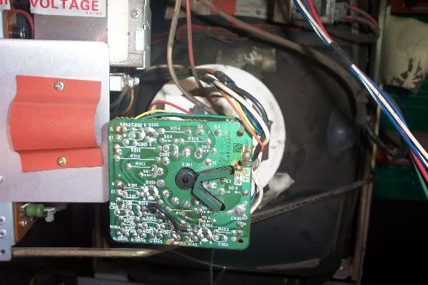

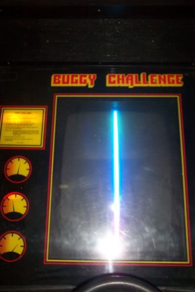

I have collected games for a while ( but they all worked good ). Now I am trying my hand at fixing a couple. I got a Buggy Challenge game givin to me that has a monitor problem. The green pcb ( chassis ) that attaches to the picture tube was broke in half and the screen had no picture, I tried to glue and solder it back together but now I only have a thin line running vertical on the screen. Does anyone have any ideas on how to fix it or where I might find a new/used good chassis that I could get for it. It is a Mitsubishi 510UKB22 tube. Thanks for any help.

OH... and don't run the monitor with only the line, it can do a burn in super fast!
