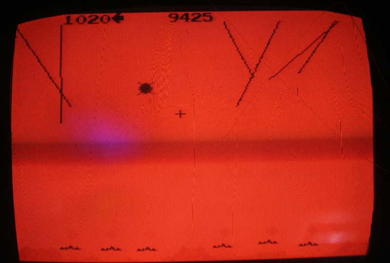

Hi.
I have some trouble getting this to work properly...
Reseated all the chips.... and...
Now, there´s clearly something wrong with the monitor... WAY to much red in there!!...
Have tried to adjust it without any luck....
Oh, and the bright spot on the monitor is from a speaker (magnet *;D)

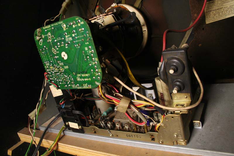

Could be any number of things. Check the edge connector on the PCB, to ensure that the wiring harness is making good contact - sometimes that can cause a color not to even make it to the monitor. On the monitor side, check the solder joints on the video input header. These very frequently crack causing lost colors.
Do you have another game/monitor you can try this on, to verify that the game board and cabinet wiring are good?

Cracked solder joints on the video input header are really common on those. Pull the chassis out and reflow them all. Also, inspect the neckboard for cracks, and ensure that none of the metal tabs on the drive transistors are touching anything.
It's hard to tell here at work, as my monitor is really, really worn out and displays images very poorly. But I see a very clear, defined red image - no haze or retrace lines, and no other colors. If you had a shorted gun or shorted transistor, you'd have a haze over the whole screen.

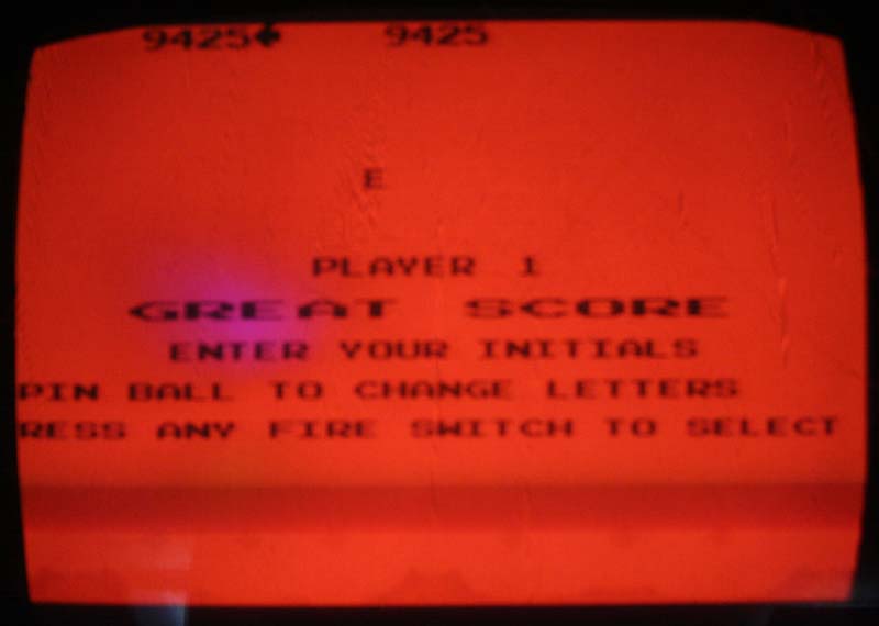

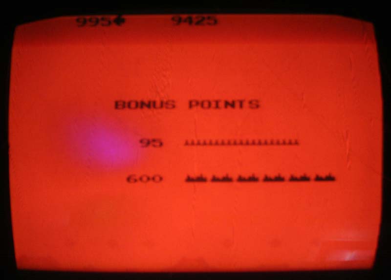

That's a problem in the video summing circuit on the board. The ICBM trails are supposed to be red, and yet the rest of the screen is red.
Yep, you're right, and the screen supposed to be black..
Can you point the circuit out on the MC PCB?? - if it´s changeable, i got 2 other MC PCB´s i can use something from, if this is "broken"....
L8, M7, L7, in that order.
It could also very well be the address decoder @ E8. Those 42's are notorious for failing. If you have a logic probe check the output of E8 pin 4.
