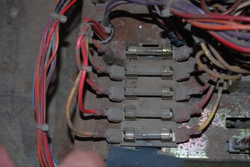

So I'm trying to put this back togther. I think the terminals get screwed to the brick when its mounted to the bottom -- True?
Pic:
http://www.flickr.com/photos/58441349@N04/5365229458/in/photostream/
if someone has a pic of theirs and how its get mounted.
Alos looking of a close up of the AR board and connectors with wires visible -- my harnes has 3 of the 3 connectors hacked off -- I got new connects and working on getting wiring pieces -- just to make sure I wire it up right!!

True

How about the terminals I have in the pic with the power brick? do they bolt to the bottom?
when I got this is was jamma converted and had been disassembled so the round terminals were not connected to anything -- Are they hacked? they don't look to be -- they look they same connector/terminal as the ground terminals on the interlocks
Mostly after the terminal/brick connection info.
I have a MC cabaret at home. The back is off of it and I can get to it (surprising). If you can hang for about 90 mins, I'll take some pics and post them here for you.
Tom
Its filthy but it may help:
