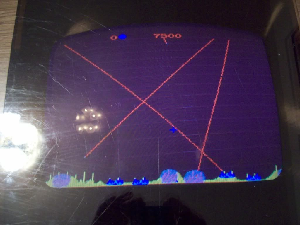

Here's what the city graphics look like:

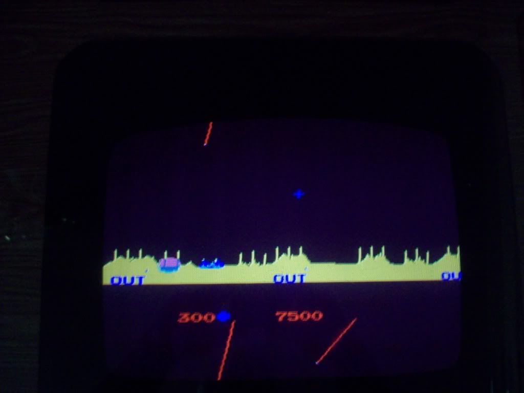

Here's an example of the "static":

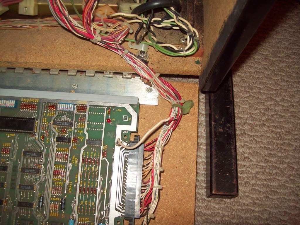

Also, someone did a wire hack here:

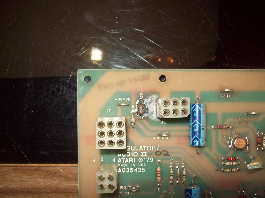

And finally, this part was damaged on the old ARII board but putting in a non-damaged one didn't see to make a difference. What is this part?
The burned component is R30, which is part of the 5V sense circuit. YOu also have a hacked harness there with that fat wire soldered to the board (ground or 5V return). Seems likely they are related (think AR-II sense mod).

You should rebuild the edge connector on that game tho and elimintate that
nasty hack. Check the connectors on the AR-II end also just to be sure.

That's an interesting problem! At first I thought bad DRAM(s), but then it appears to be only in the 3rd color region with the cities. I don't have the schematic in front of me but I'd say there's a problem with how the address circuitry is pulling playfield data in that region. Whatever it is, I can fix it. :D

I noticed the static like graphics are from overscan. The horizontal width needs adjustment. Going to get a tool for that and fix it. You'll notice above in the pics that it only occurs when the ground is overscanning outside the sides, mostly at the bottom. So I am removing that from the list until I get the adjustment right.

Lastly, I think the city graphics are the only part that are caused by the PCB. Notice how after they are destroyed they have vertical "spikes" coming out of them.
