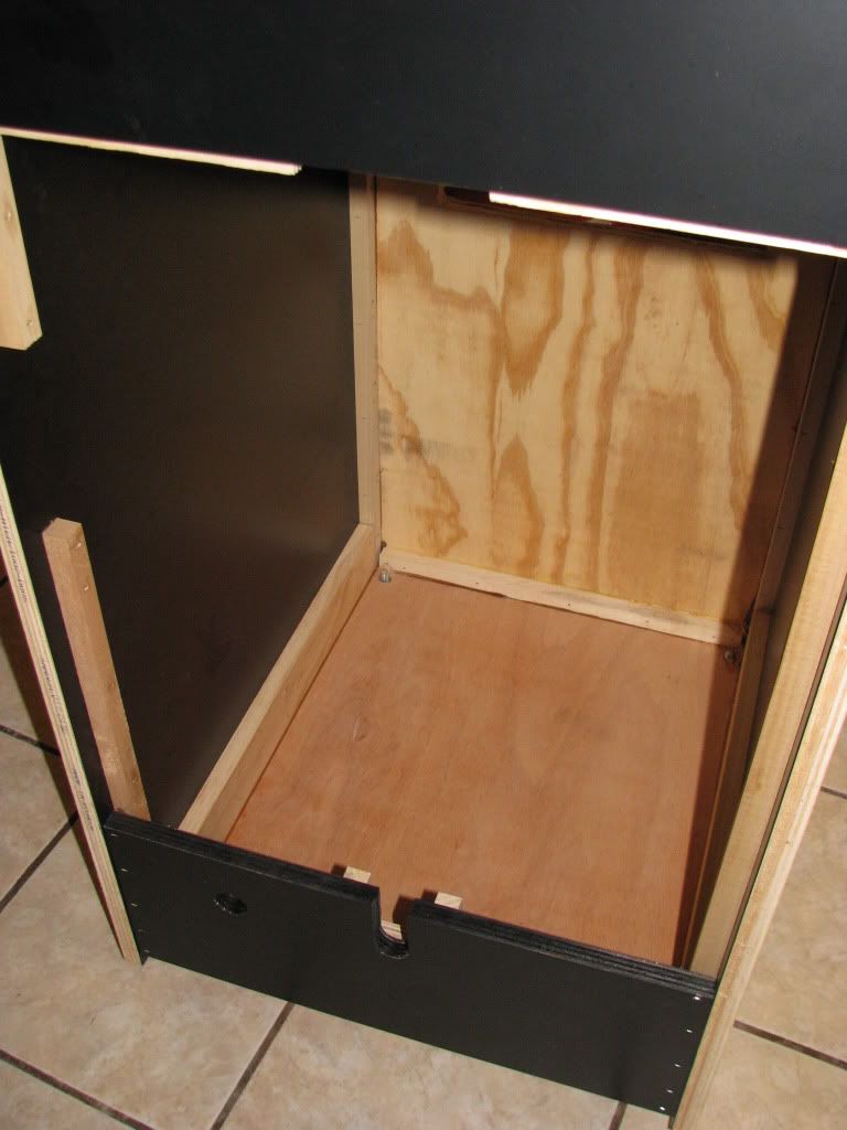

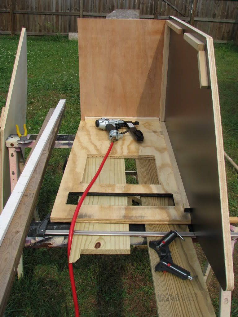

I haven't updated this in a while, so here goes:

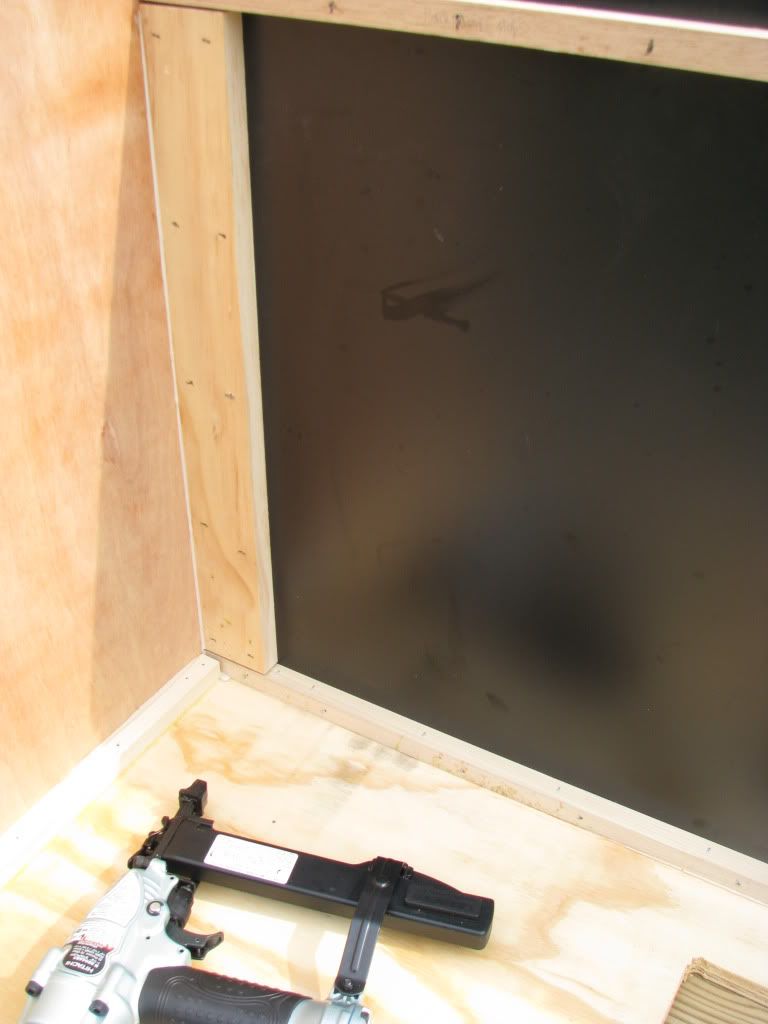

I had the side panels made, with matte black Formica applied to inner sides. Had most all of the pieces cut, but ended up cutting a new bottom piece, as I'd screwed that piece up.
I also got a Hitachi 1/4" narrow crown stapler and am using it for the assembly, with glue, basically what was done originally. I'm trying to space the staples out the same, but am a bit loose with that.

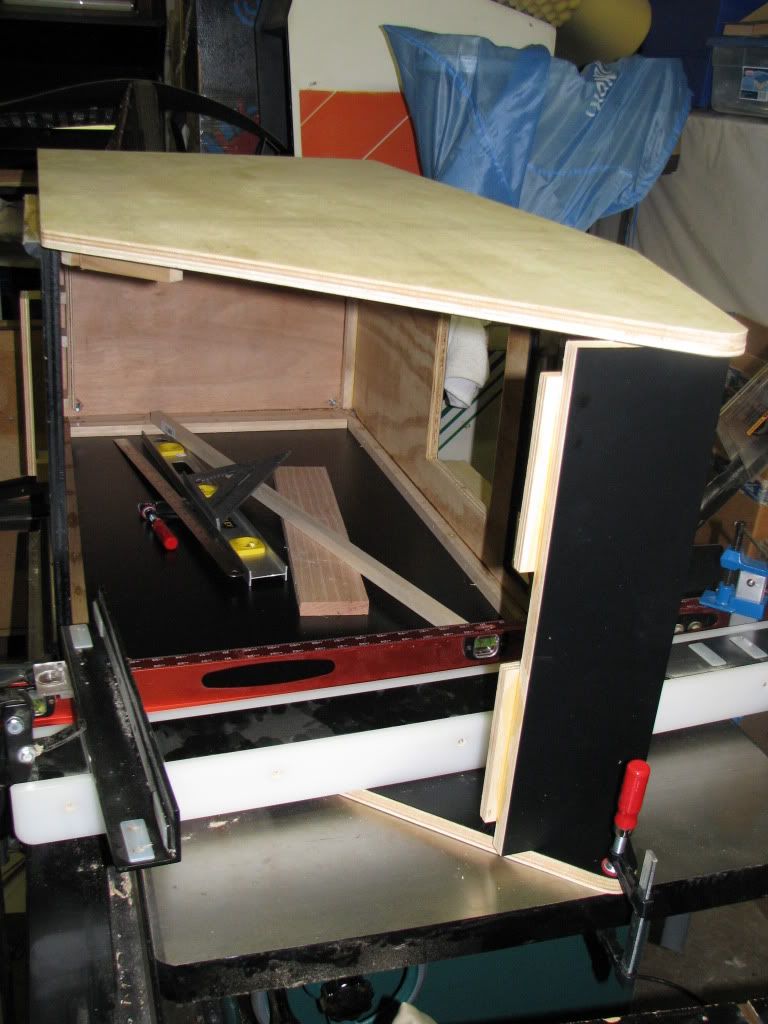

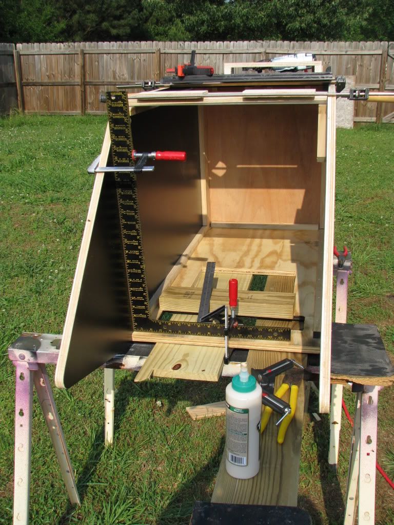

As I went to install the upper rear and top panels, things just weren't lining up. It was as if the cabinet was skewed and it was. With those plywood side panels sitting for months, one had warped quite a bit. It bent slightly inwards as it went towards the top.
I put the cabinet, warped side down, on the tablesaw, then clamped that side down and weighted it also. Left it for a couple of weeks and it mostly flattened out:

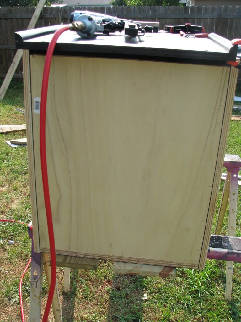

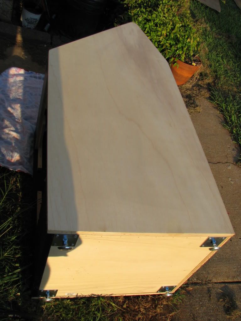

After that, I was able to install the top and upper back. The mitered edges butted up almost razor sharp. Again, I tried to staple it, as the factory did-

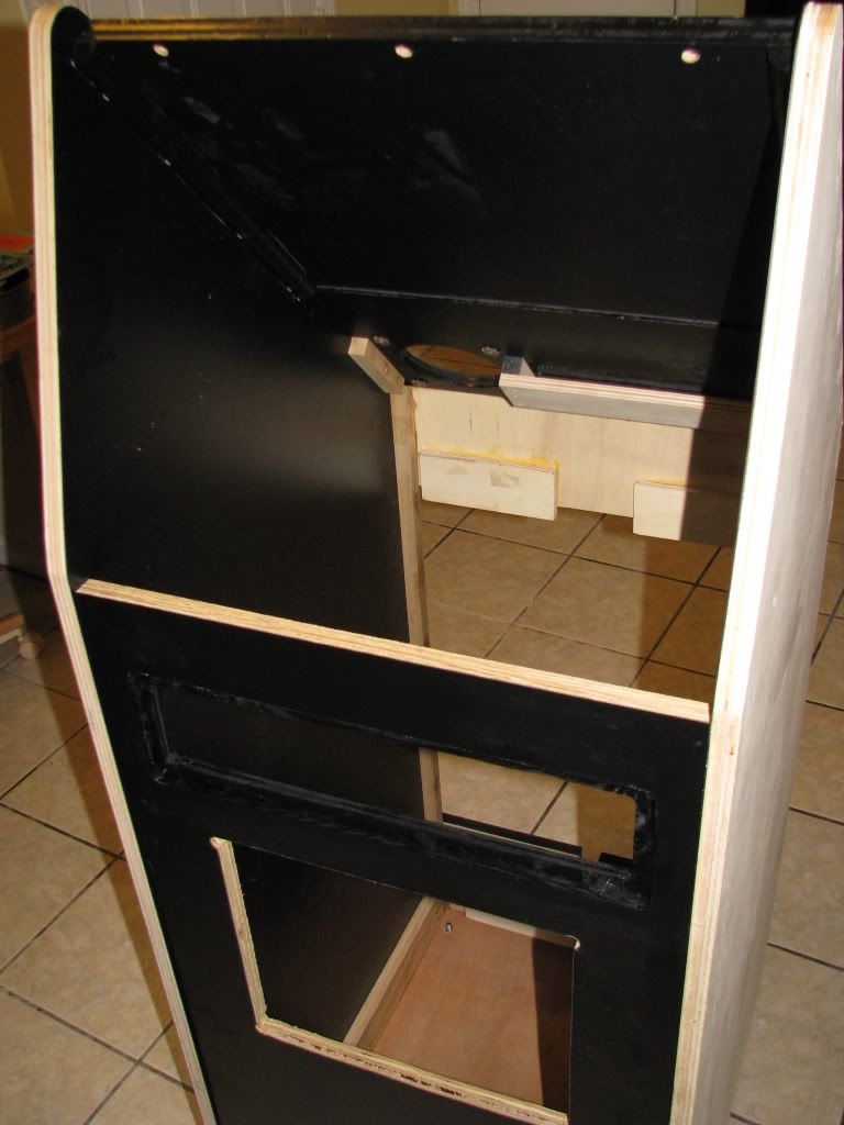

More pics:

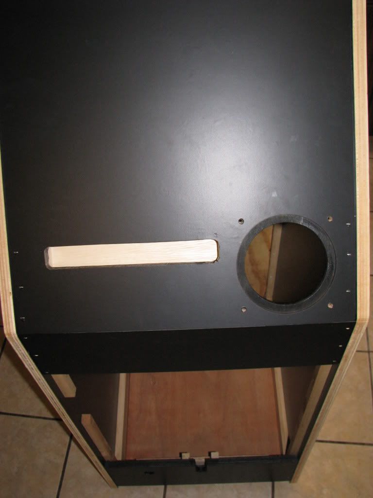

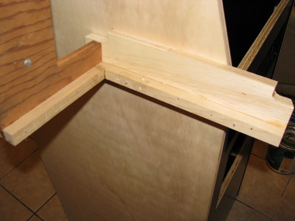

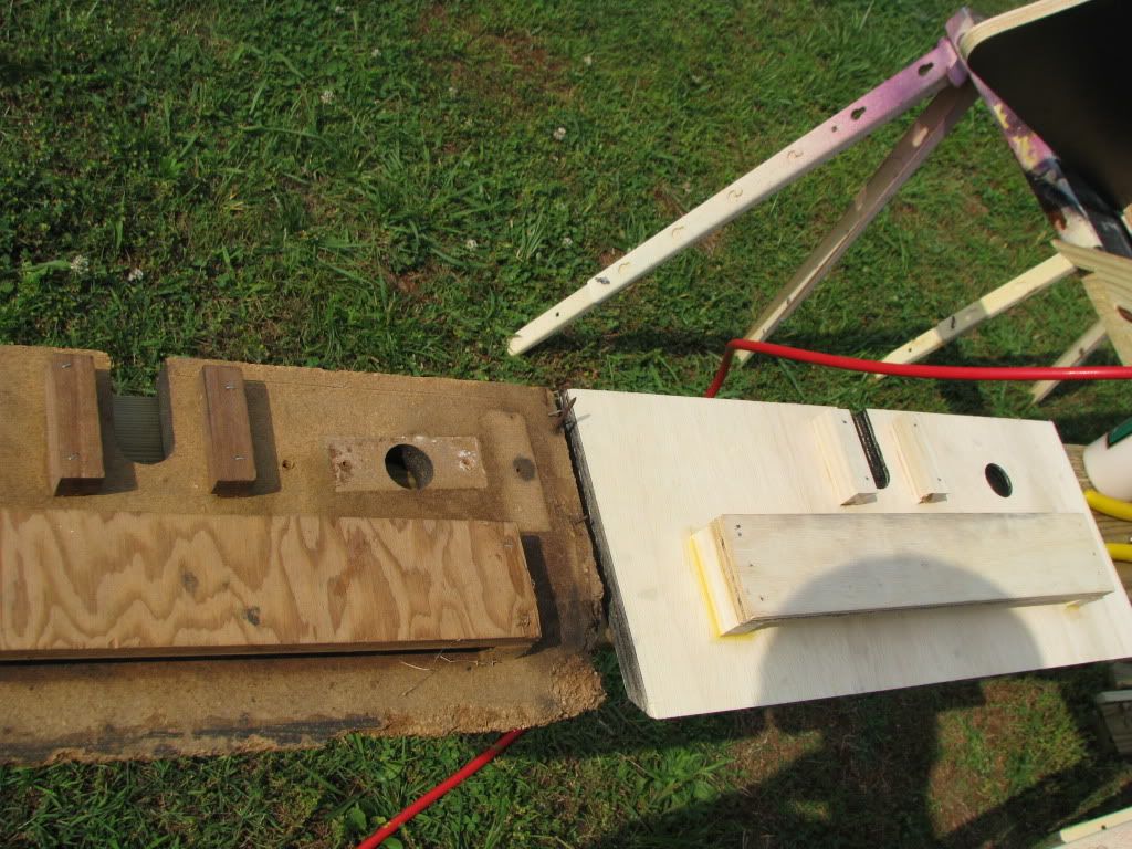

Here's the coin box support thing, before the mortise for the bracket:
before and after, in progress:

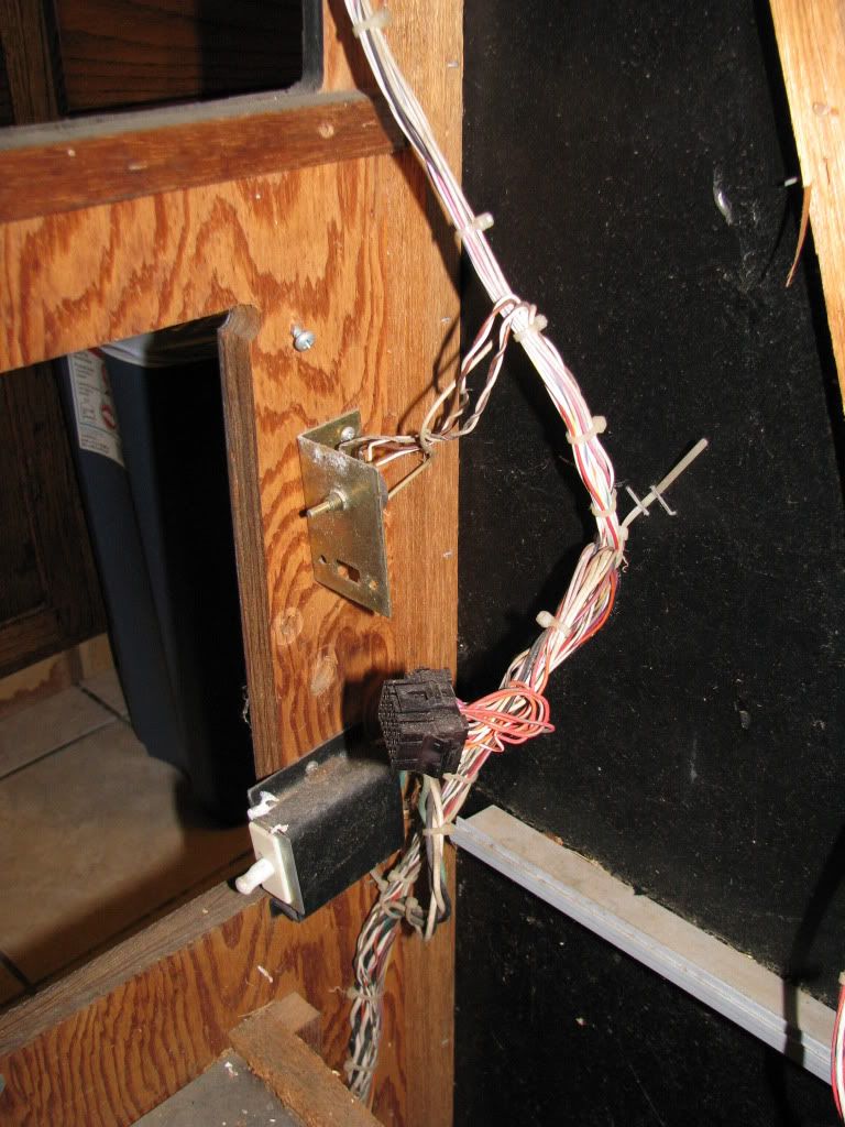

I will have to reinstall the wiring harness, with the wire ties stapled, as originally done in the old cabinet:

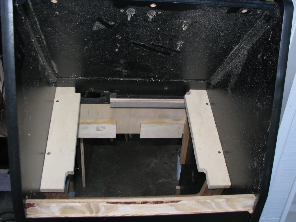

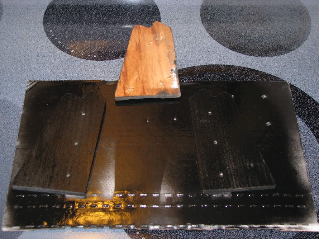

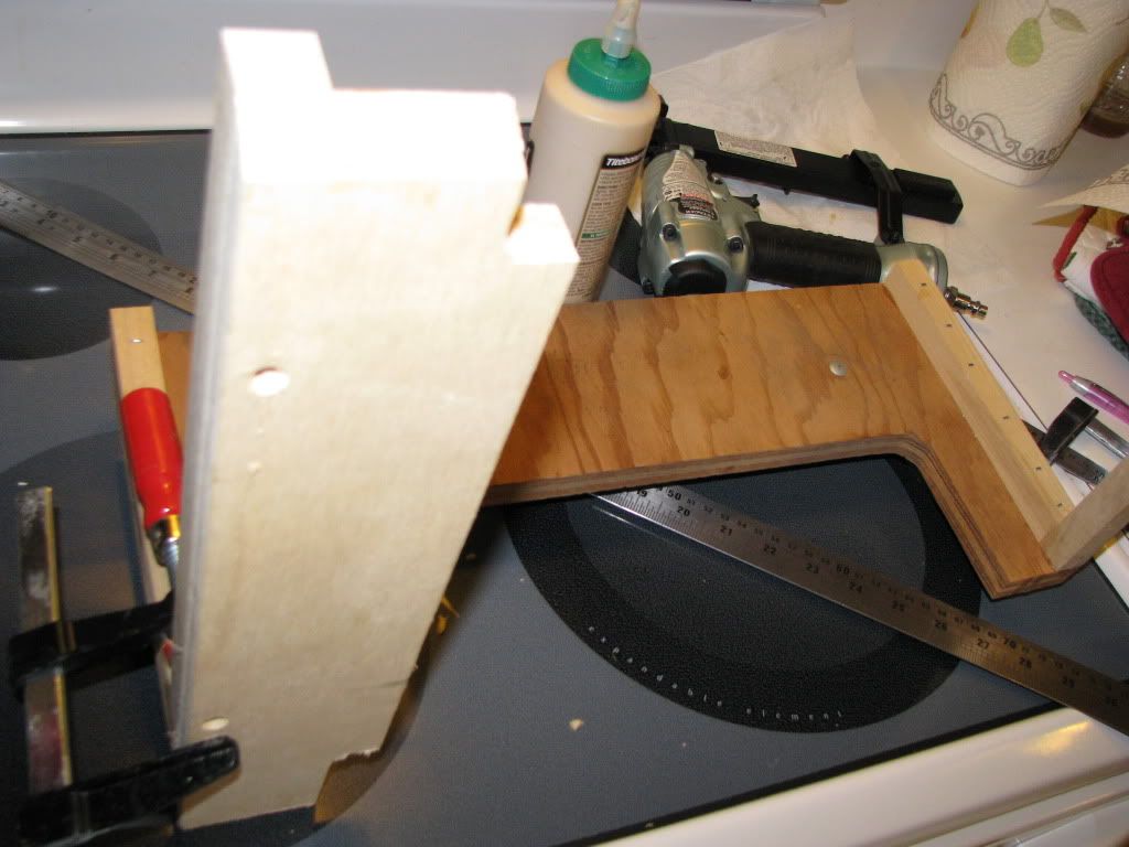

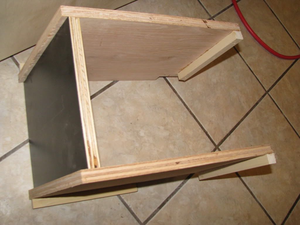

For the monitor mount assembly, I did reuse the one piece, cutout with bolts for the marquee light to mount to. The actual 'wings' that the monitor mounts to, 3/4" blocking, etc.. was replaced. I counter sunk those 2 holes on each side (although it was glued AND stapled from the bottom), because the original was done that way. The old screws were rusty, so I ended up using powdercoated deck screws, sprayed satin black.
Here's the completed monitor and light fixture mount assembly, hanging on the cabinet, before installation:

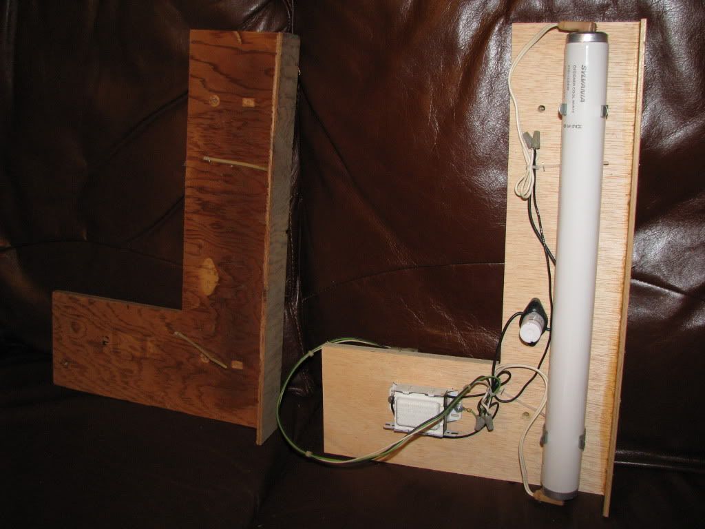

Because the old light fixture board was smelly and nasty, I cut a brand new piece, installed a new ballast, starter, and correct sized bulb (for those brackets), and even stapled the wire ties, like the old one. 1/2" birch and 1/4" birch plywood:

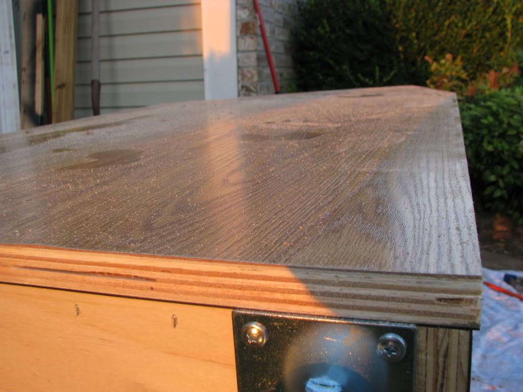

I used a water based Minwax clear on the sides, 4 coats, sanding between each, getting it smooth as silk. I had planned on using woodgrain vinyl, but Arcadeshop was out of it.

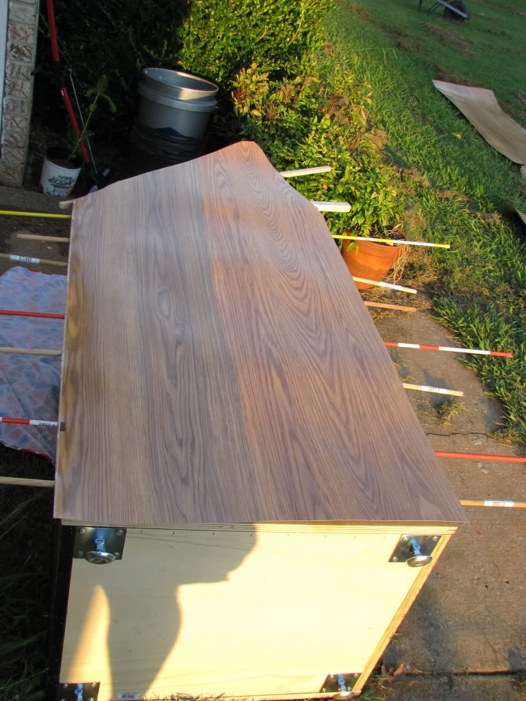

By some near miracle, I found a few sheets of woodgrain laminate for cheap at a surplus (junk) store. These were in a pile, cracked, brittle, and where you get just enough out of one sheet. I think I got enough after this cabinet to also do one more cabaret build and a Frogger front (another future thread).

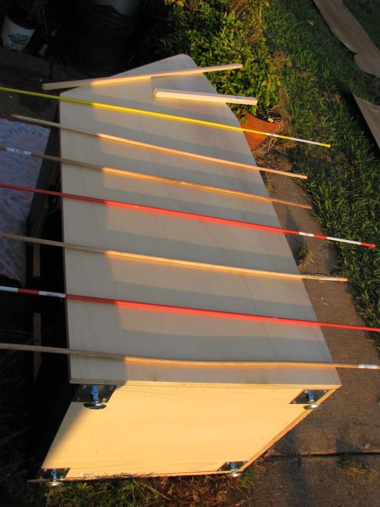

I gave it a light sanding, got the surface free of dust a debris, then used contact cement on the cabinet and laminate, applying with a foam roller. I then applied it, then put a lot of pressure on it, rolling with a j-roller. I then flush trimmed with a 1/2" flush trim router bit. Some pics:
I actually messed a piece up, pissing me off.. You have to use dowels so that you can position the laminate before letting it down to stick, picking a starting point and moving tightly in one direction - as you would with a decal. This stuff is vertical grade and very thin..it drooped and stuck before I was ready, not aligned. I had to pull it up and cut another piece, apply more contact cement.
These pics are after the trimming with the router:
I had a slight tear at one edge on the other side. Not bad enough to redo, as I'm short on material, but not perfect. It'll do.
