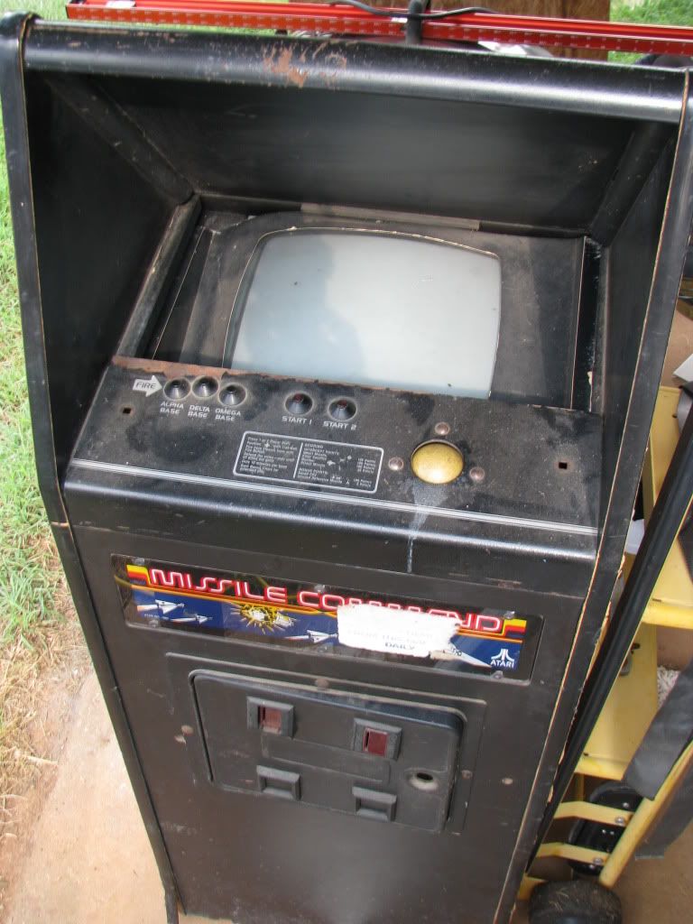

I won an Ebay auction for a Space Zap mini in 2010. When I phoned the seller about picking it up, he offered to sell me the Missile Command cabaret, which was in rough shape. I thought it sounded like a fun project so I jumped on it.
Sidenote.. I ended up trading the Space Zap for a Berzerk project, but that's another thread in the future.

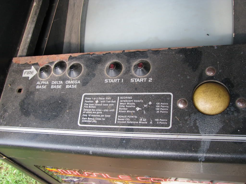

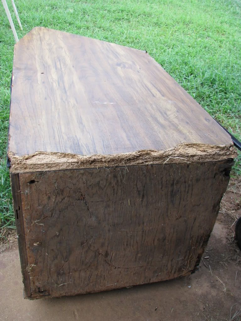

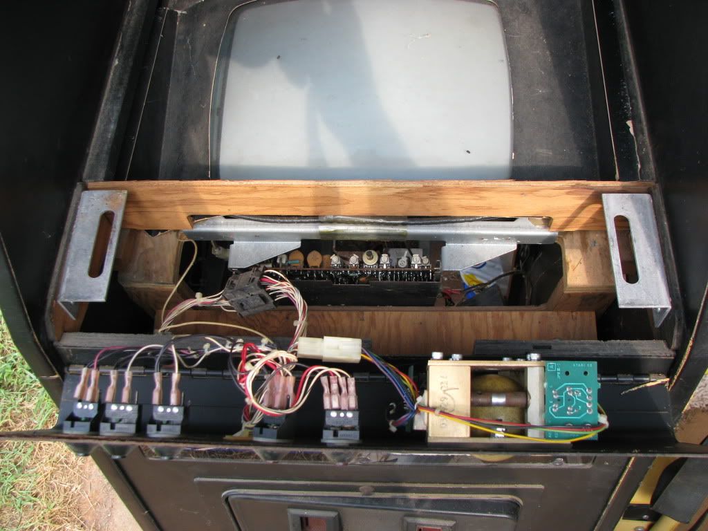

The MC was rough..and as far as I was concerned, the cabinet a loss. Mice had been in it, stained wood. Quite a lot of swelling at the bottom, crumbling, and general rot. While the cabinet was rough, the monitor, boards, harness, etc.. were dirty, but totally fine.
This thread will document the total restoration of the MC cabaret, including building a new cabinet from scratch.
Instead of particle board, as originally done, I decided to build the cabinet from 3/4" sanded birch ply. For some reason, I also decided that while parts that were vinyl covered, would be done that way in general, I would use matte black formica for the inner cabinet sides. It's overkill, but I don't regret it.

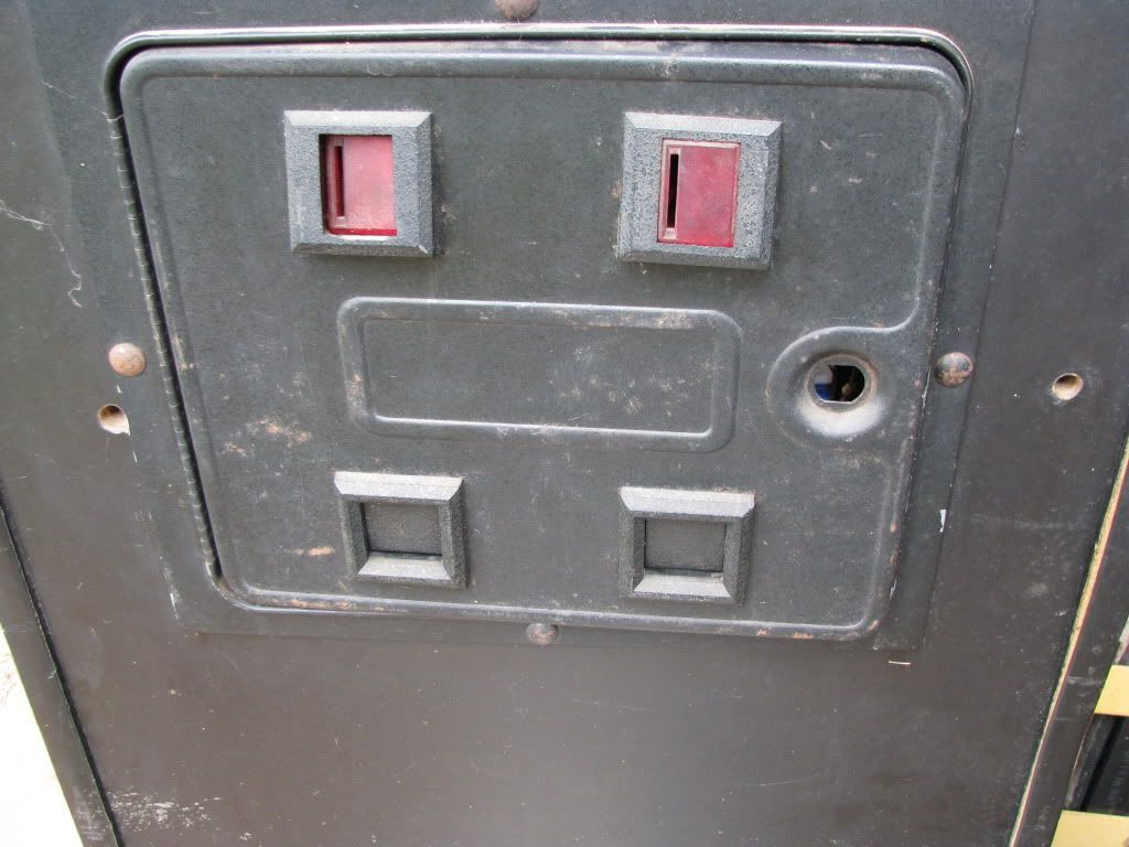

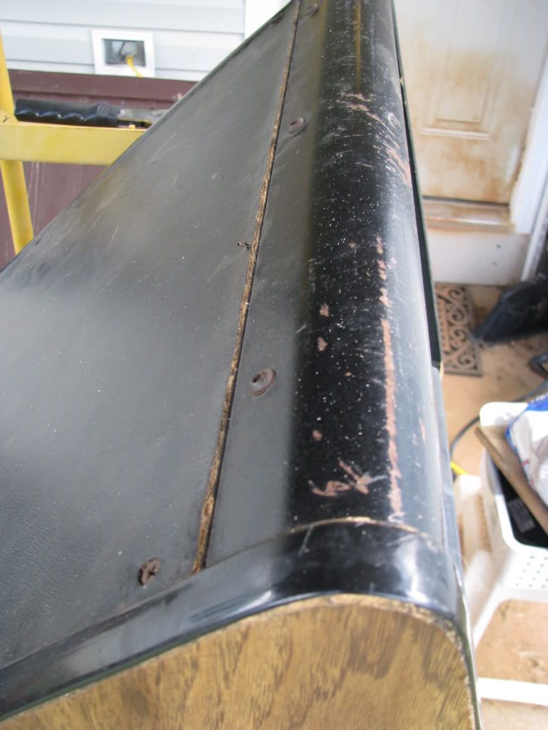

Here are some pics of the cabinet, as I received it:

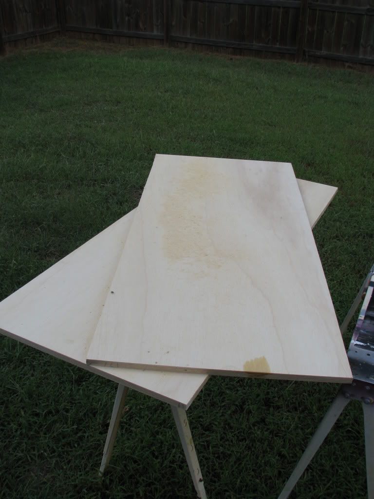

I started by making the new side panels. I cut down the 3/4" ply to the exact width (front to back of cabinet), and a bit taller than the cabinet. The plan was to get the square cuts exact, trace the panel, rough cut, then clamp in place and follow the profile with a flush trim bit.
Here, the square cuts are done:
I clamped it in place, then traced the outline of the cabinet, so I could rough cut it with a jigsaw:

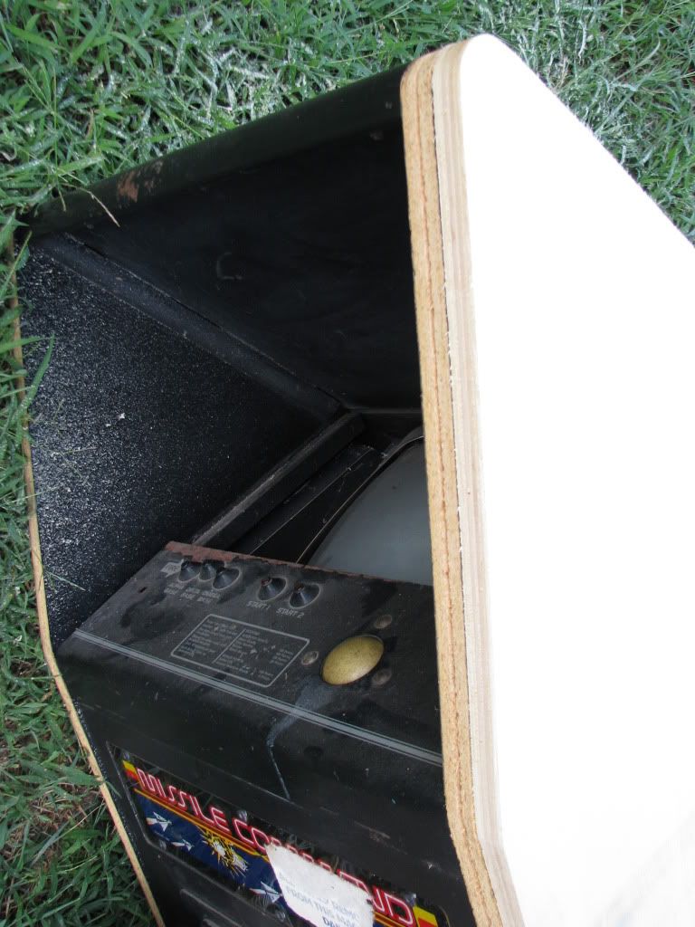

I clamped the panel in place, aligning the square edges to the original cabinet:

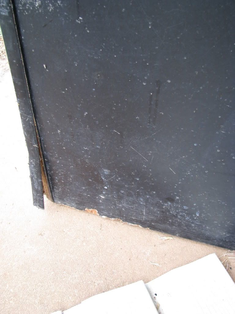

This illustrates how blown out the bottom edges were:
Skip forward, blah blah router dust, and I used a flush trim bit with the router to 'trim' the new panel to match the original profile.
That part of the original cabinet was not swollen or damaged, so it served as a good template:
Finished panel, did the same for both sides:
I started by cutting a replacement for the rear, lower panel. It has a miter cut, where it joins the bottom panel, but the miter was nearly gone on the original piece. Here's the original and the replacement, correct size believe it or not:
As far as an entire panel went, this was by far the worst condition:
Inside reference shots, necessary when I have to reassemble (and have forgotten everything by then...)
More inside reference shots:
Those pieces that the top panel sits on are apparently quarter round molding... I have since cut new pieces and finished them in RustOleum satin black..

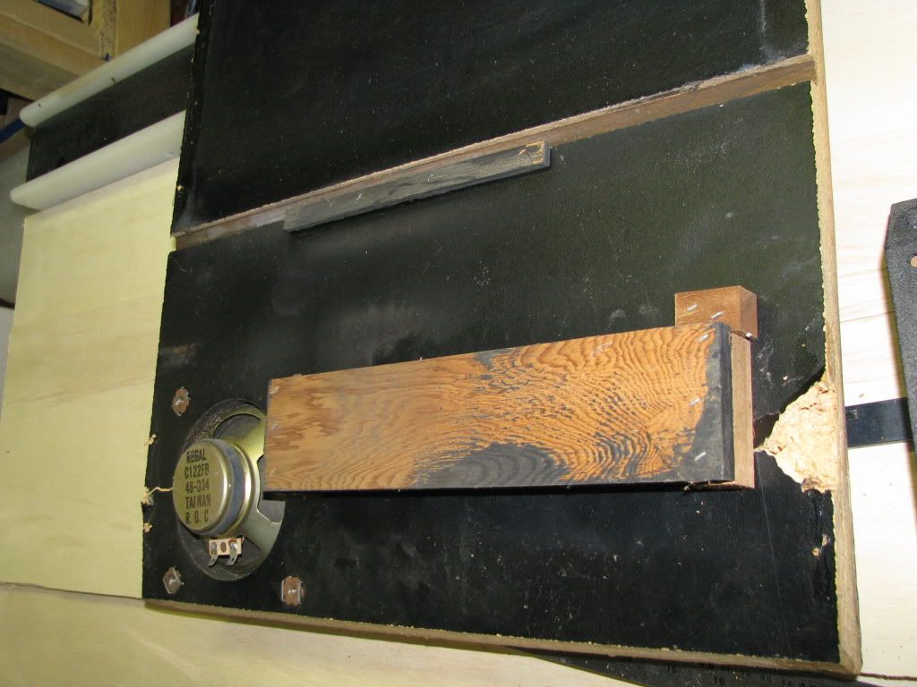

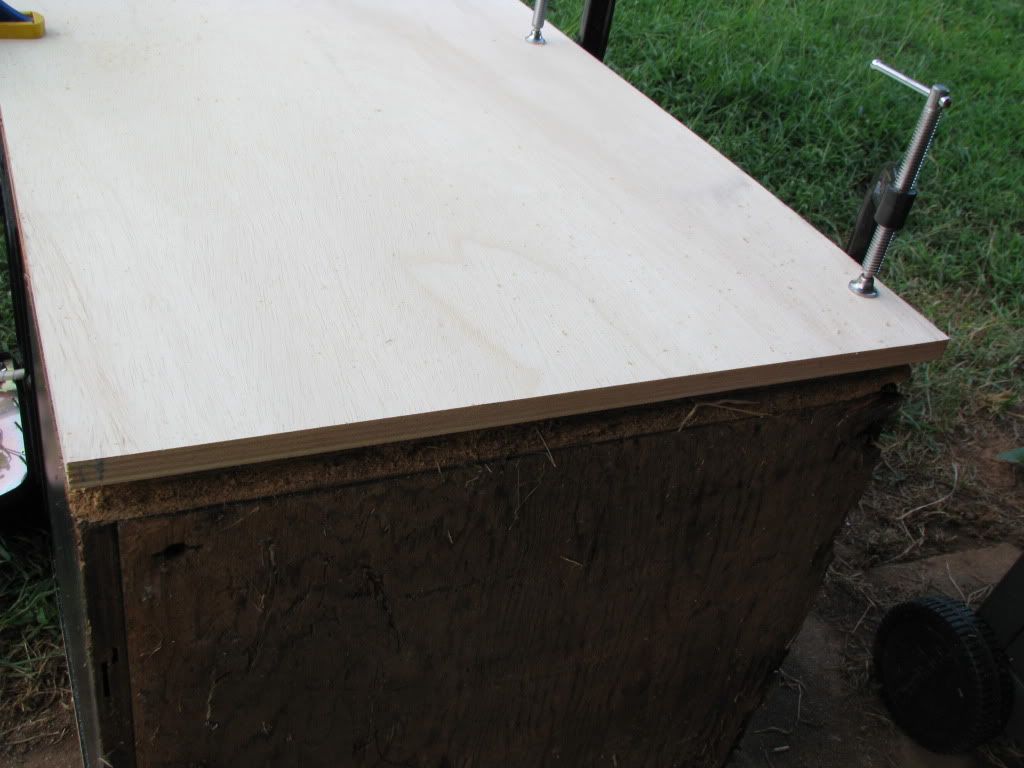

The top panel was in rougher shape than it appears. It was cracked, making it seem hinged. There were plenty of fun cuts to make here:
The special cuts:
-cutout for speaker
-rabbet for that hole
-cutout for vent
-miter cut on edge that joins to upper back
-rabbet for front/top metal bracket/trim
-slot for monitor glass
New plywood looks so much better than that swollen mess:

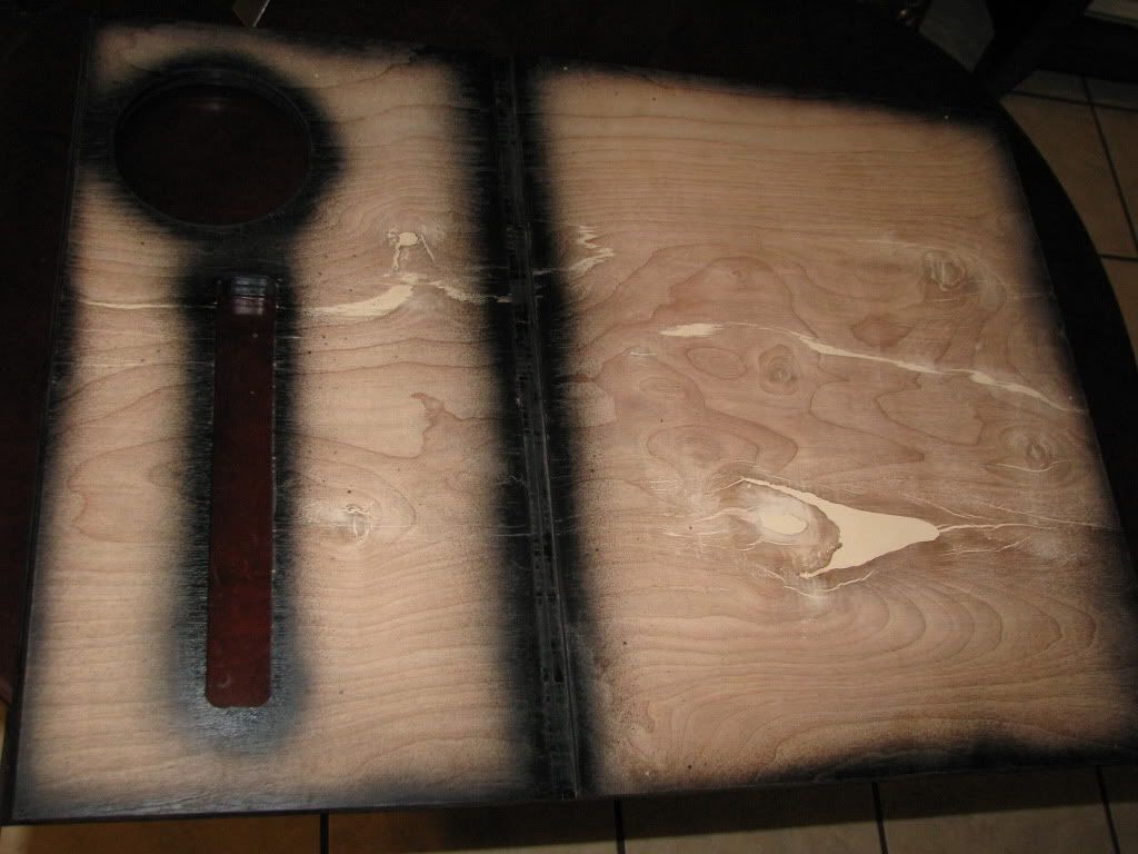

After filling any knots or splits in the top ply with filler, I sanded it with 220. I sprayed all areas that would not be covered by the vinyl, then later sanded again to get it slick.

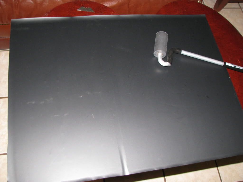

After making sure the surface was smooth and removing all dust, I applied black vinyl, from ThisOldGame, using a j-roller and a beer (not shown):
There are some smudges in the photo, but the vinyl went on perfectly. Even though this is plywood, no grain is really visible. The wood has been sanded so smoothly that you would think this was PB or MDF.
