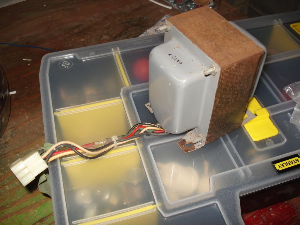

So I have an old Missile Command that has been parted out. There were two ISOs in the cab, one standalone, and one that is part of the power brick assembly. I'd like to use the standalone ISO in a JAMMA cabinet for the monitor. How can I test whether the ISO is good, and how to wire it up? There are no markings on the ISO, and 5 wires going into/out from the transformer.

It's NOT part of the brick assembly. There is one that is attached to the power brick itself, and one that was loose or bolted to the bottom of the cab. I'm talking about the latter. Pics will come tonight.

Here's dem pics:
Like I said, no markings, and no lugs.
Whoa, that's a beast of a transformer. Looks kind of like the one that was installed in a pinball machine I bought from Canada. Apparently electrical code up there required an isolation transformer for the whole machine. Mine had a standard 3-prong cord & a 3-prong plug on one side.
It's hard to be sure without markings, but my guess is that it likely is an isolation transformer (and a heavy-duty one at that). You should be able to take the side covers off and see the lugs where the wires connect to, and/or probe the wires for resistance to see what's connected to what and reverse-engineer it.
That green tag looks like an Atari tag. Can you read a part number on it??
