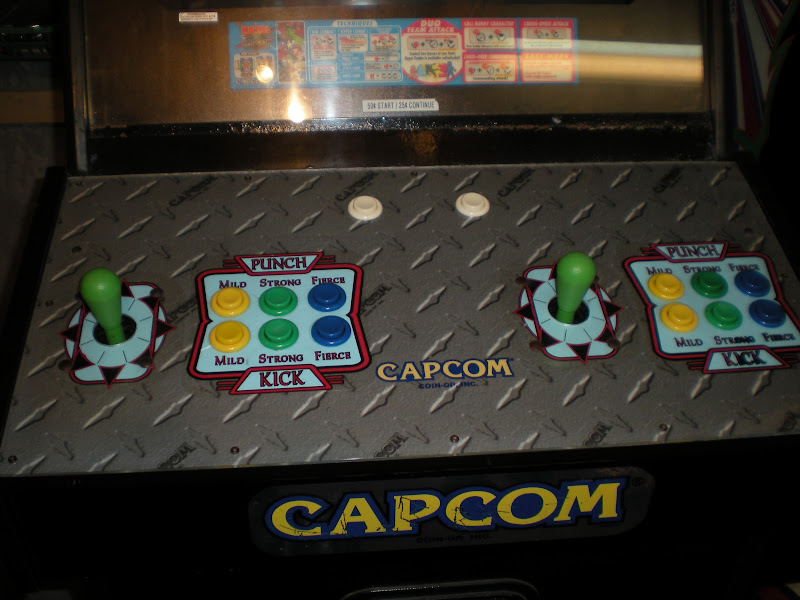

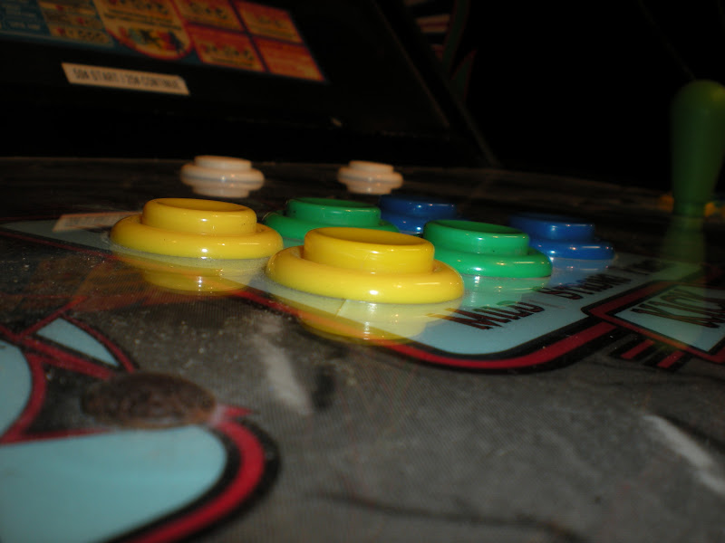

So I got my order of competition buttons from Lizard Lick yesterday in the mail and I finally got to install them. I was worried that I would not know where my fingers were located with the competition buttons, but after asking my wife for an opinion I decided to give them a try.

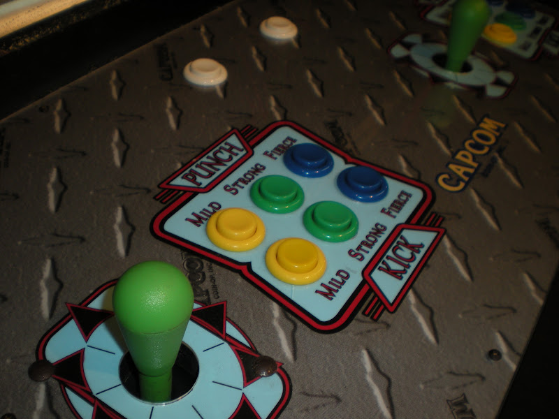

Here is what my control panel looked like before:
And after, notice I got player 1 and player 2 embossed buttons:
So now I have competition sticks and buttons in that cabinet.

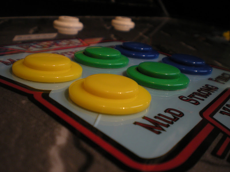

And the difference is very noticeable, my fingers can move from button to button easier and the throw of the button seems shorter. I will definitely keep them in this cabinet. And my Neo Geo feels not as good with the standard buttons, but I don't know if I will switch them in that cab. I think it all depends, with the MVC I want a really responsive panel that my fighter fans can play with me and not complain about the buttons. They all have Sanwa sticks and buttons in their homemade PS2 arcade sticks.
I also got new buttons and sticks for the MK1 I just got, but in this case I stuck with the concave buttons. I think that it would be weird to have competition buttons in a MK1.
My only complaint is that the buttons came with some really cheap looking switches, I wonder how long they will last.

Competition are much easier on the fingers and you are correct in your assumption about the throw distance. The button sits almost on top of the switch on the comps while there is a slightly larger gap on standard buttons. Can you post a pic of the microswitch? They should be Cherry. Cherry is the longest lasting switch you can get and they're not stiff like most chinese switches.

And the switches are not Cherry, I wish I could find a source of cherry switches on the cheap. Lizard Lick charges more ($2.50) with Cherry switches then they do for buttons with Chinese switches ($1.70)!
If you bought Happ Competition buttons then they come with Cherry switches. The $2.50 buttons are Sanwa. Sanwa are a lot and I mean a lot more sensitive. Because of this they are only rated for 1 million cycles while the Happ with Cherry switches are rated for 5 mill.
If you pull one of the buttons and look at the switch it should be white with a small red button. It'll say Cherry on the side as well.
I wouldn't worry about replacing the plexi overlay. It would be a waste of plexi to do so. It looks fine and the crack is barely noticeable. I was just razzing you a bit.
The competition buttons I bought from Lizard Lick are actually iLs and come with e-switch switches. If you look on the Joystick page on Lizard Lick they sell Cherry micro-switches (not buttons) for $2.50 each. This is the only place I have found Cherry micro-switches for sale. I need to see if I can find them on MCM or Mouser, I imagine that they would be cheaper through them.
So when you bought the buttons he gave you IL? That's strange, all the comp buttons I've bout from LL were Happ and came with Cherry switches. The distributor I buy from locally also sells the Happ comp with Cherry switches. You might want to shoot Chad an e-mail and ask him about that. Maybe he sent you IL comp buttons since you ordered IL comp sticks?
I certanily did not order iL sticks! I hate those sticks!! The sticks are HAPP, and come with e-switch switches. I have bought HAPP sticks for a while now, and it has been years since I got one with cherry switches. I also ordered HAPP competition buttons, but when they came they have iL logo on them by where the switch goes.

You DO know that HAPP used to buy their sticks from IL until about a year ago...so the original HAPP Comps were, in fact, IL sticks... and the new HAPP Comps are, in fact, Chinese made crap. Right?
The easiest way to know if you got HAPP (Chinese crap) or IL (The original HAPP Comp) is to look at the dust washer that came with the stick. If you got black dust washers, they are HAPP (Chinese), if you got dust washers that are the same color as your stick, they are IL (the better of the two).
