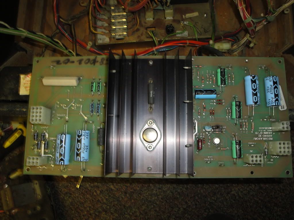

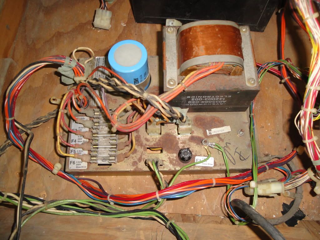

So Im trying to wire up a Millipede cab and I keep blowing 2 fuses whenever I turn it on. I have narrowed it down to the AR2 board. Can someone help me with the wiring? There are 2 connectors that are keyed the same.
Here are some pictures. For the wiring the 2 on the left are the ones that are keyed the same.
Ooops
Forgot I had these already taken...see if they can get you started. If I am not mistaken, one of the 12 pin connectors goes to the CP and the other to the coin door...but I am not sure on that.
Also, I have found the schematic to be relatively accurate when I was troubleshooting mine - you can get it and the manual at Mikes Arcade.
One more thing...check R29 - hard to tell from the pic but it may be fried. It is part of the sense circuit for the +5v.
