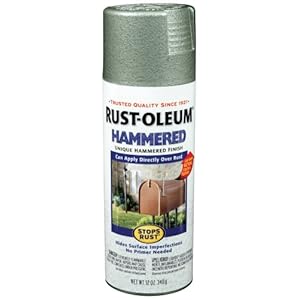

I'd use a fine grit for sanding if you even have to sand, I would think the wire brush will take care of the rust, if you have dent's you can Bondo them as needed/sand for a smooth finish, the coin mech fronts are aluminum so they wont rust, again I'd wire brush them and only sand with a very fine grit if needed.
I repainted mine with the hammered finish silver paint:
