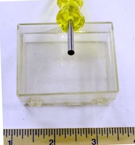

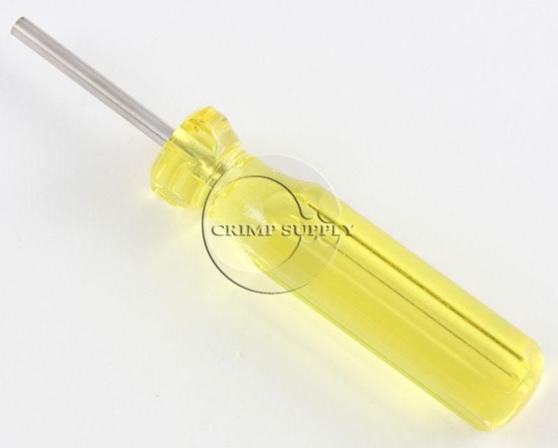

FYI - if you need an inexpensive place to get your hands on a pin removal tool, you can find one here:
http://cgi.ebay.com/ws/eBayISAPI.dll?ViewItem&item=370504592169
It's marketed as a Delphi pin extractor, but it's the right diameter for most of the molex work we do. Fits over both the male AND female pins. Male pins require a bit of jiggling to work them lose, but it works. It's GREAT for the female pins, which are usually the most difficult to remove anyway.
