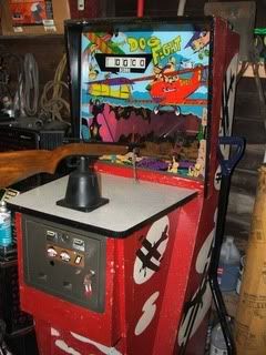

Thanks for the info. Nothing like trying to troubleshoot something that isn't broken. :) Here's a pic of my Dog Fight. Looks like someone re- stenciled it at some point, but did a real nice job. The colors match good. It has a plexiglass bezel, which seems strange, but I doubt they would have ever reproed them.
