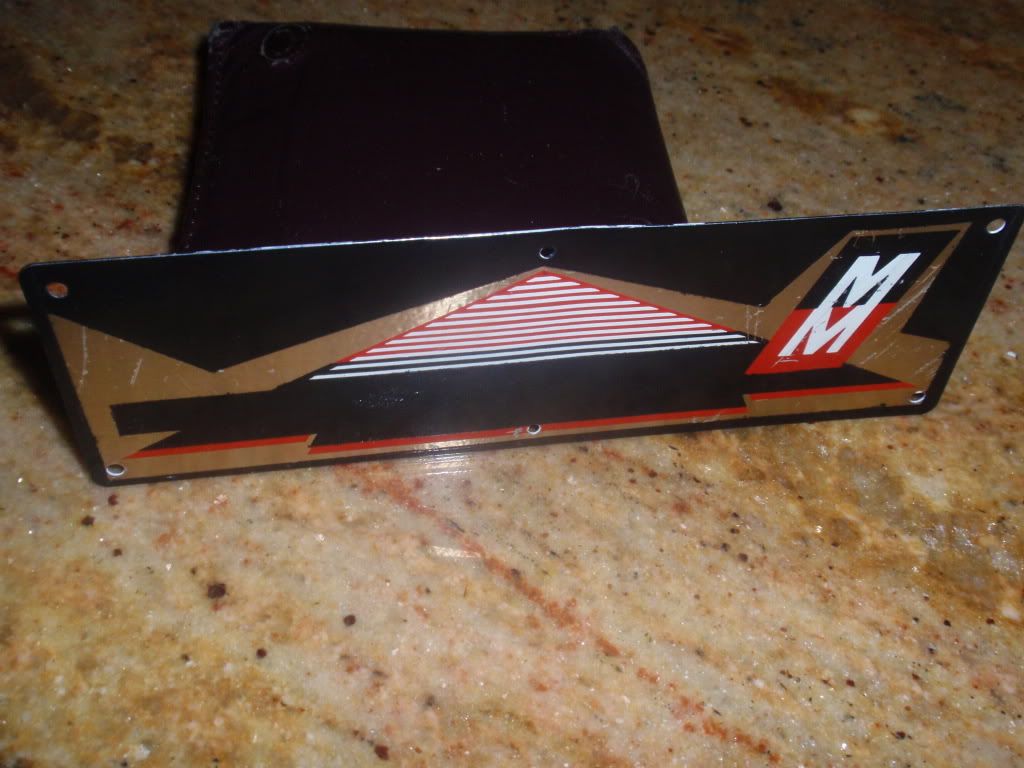

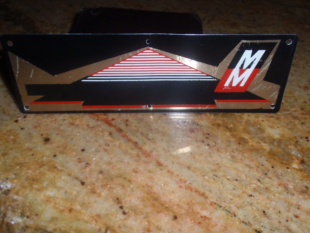

So I am reviving this thread because I tried to save an old Midway coin door plate by masking and painting the most damaged black areas. It still has a few scratches in the bare metal areas, but I think those add character. I also clear coated this entire badge after I masked and painted it to protect the whole thing. I really think these are worth saving:
Now, I tried an experiment with pop rivets, but I don't like the way the back side of the rivet remains tubular. I was using a Surebonder swivel head rivet gun, but it sucked. Can anyone recommend a better rivet gun where both the front and the back of the rivet fold up flat and tight to the surfaces being fastened?

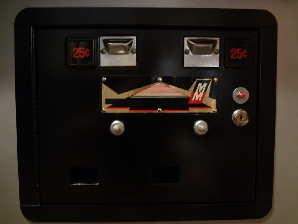

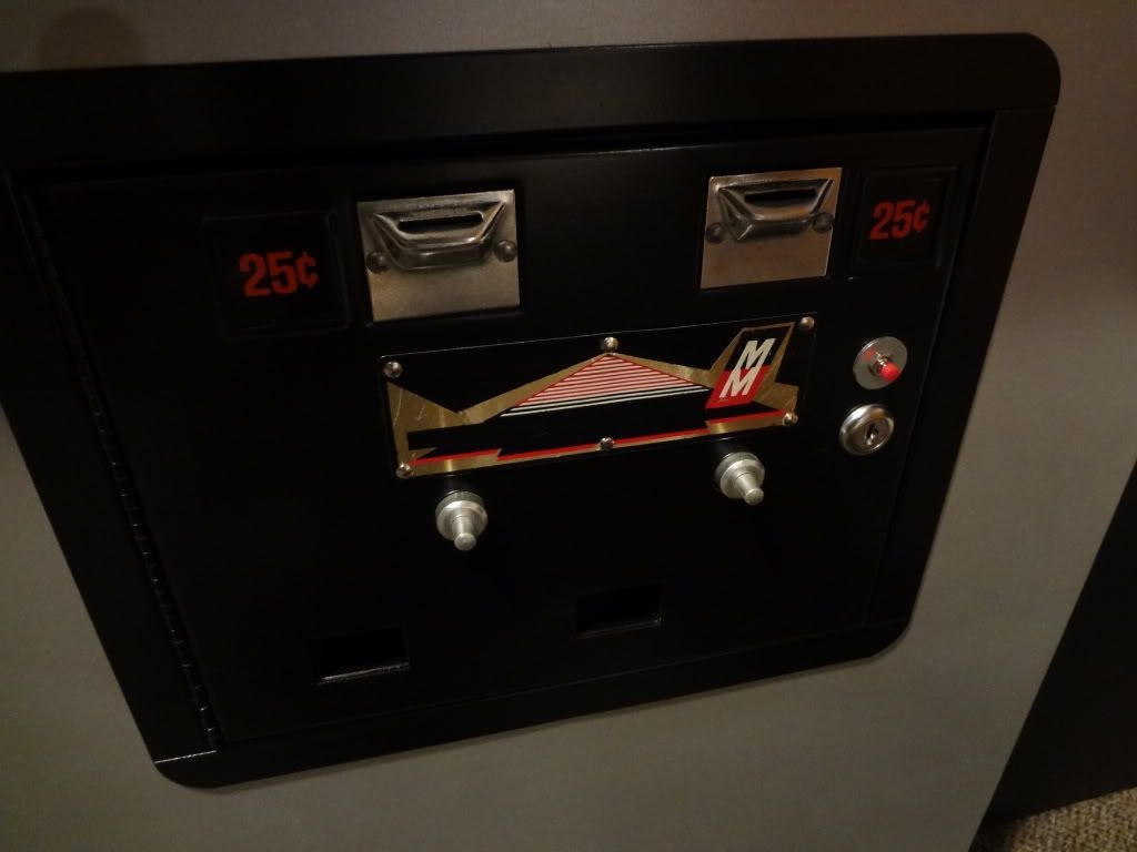

Alright, finally a follow-up to this thread. I was sent some split rivets from Riptor a while back and just finally decided to try them on one of my older Midway badges and one of my freshly powder coated Midway doors. Now this solution isn't perfect, but works. The split pin has a slightly bigger shaft and head, so you do need to widen the existing holes a bit. You can use small #6 washers for a tighter fit on the upper holes, but those washers won't fit into the lower holes due to the structure of the coindoor. To install them is a little barbaric and inexact. I used a large flat blade screwdriver and a hammer to bend them over. Be careful, as it is easy to snap them off if you pound too hard. Here is the result:
