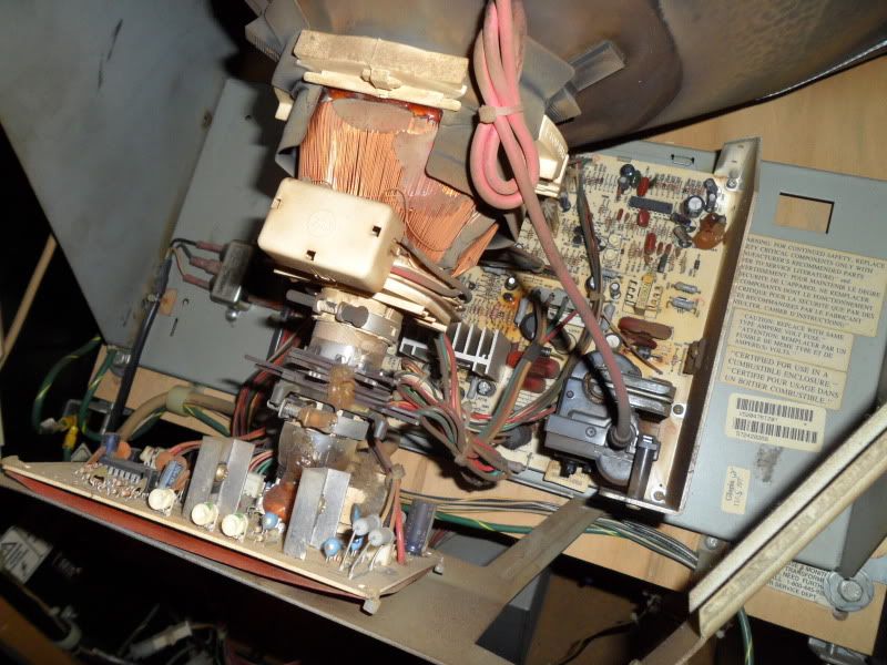

Ok, so I have looked all over the cab, inside and out, and can not find the key inside the machine anywhere, let-a-lone where it would go. It was transported to my parent's house completely together, so if the key fell out, it would be inside the cab somewhere. Nope. Not that I can see anyway. Here are some pics. Anyone wanna point out to me where the key is supposed to go? Beats the hell out of me. The game boots all the way to the screen that says "MAXX... (where the red progress bar goes across the screen), but then says this...
Here is what everything looks like...
the PC motherboard battery is the one on the bottom PCB, the one on the top PCB is the wrong key/battery? is that the one you replaced or the bottom one, the top pcb should have the little spoon type battery holder thing, I have spare keys if you need one, lmk address and can throw one in the mail
The battery that I replaced was the one on the motherboard. Not the one on the top pcb. That is the battery that has always been in there. The only thing that's different is the bottom pcb battery. I don't recall ever seeing a security key because when I got the game, the fuse for the sound was blown. I had to replace it and never saw that security key. If it's a battery issue, what's the correct one? There is a CR2032 in there now.
The ISA card that is plugged into that board has a round silver coin sized thing on it with what appears to be a "46" in the picture.
What else does it say on that coin sized item?
There's your problem.
That's where the security key goes.

My monitor won't stay focused. I know this is usually a flyback issue. I will adjust it in perfect, then after a few times of cycling power, it starts to get fuzzy again. My question is, what kind of chassis is this so I can order a new fly...
