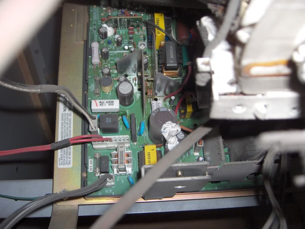

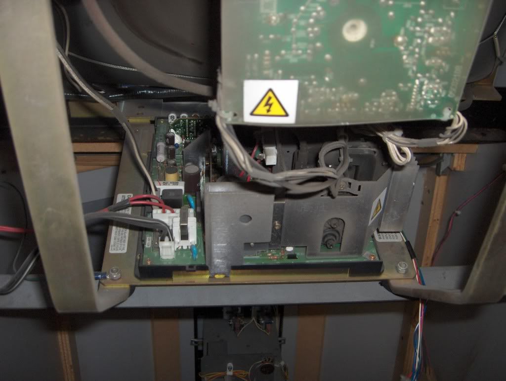

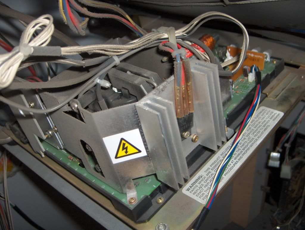

I saw a couple number not shur if these are the right ones.
3716LG
05T00905
05A0046001
If these are not correct let me know.

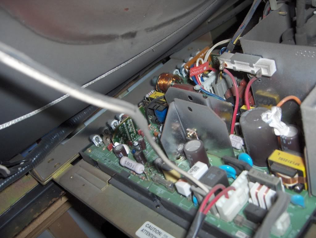

in the last pic, center of the pic, move that set of 4 wires to the other header, do it with the power turned off
I can't see any of the pictures. Can you host them here by adding them as an attachment. I am on a company computer and most picture hosting sites are blocked.
Attached them. hope you can see them now :)

Yes, that's a Nanao and it is switchable to standard resolution.
In that last pic move the harness that has the red tag on the wires to the next header in front of it. That should change it to std resolution.
http://forums.arcade-museum.com/showpost.php?p=1120617&postcount=5
Thanks guys tried it out and now the games running perfectly thanks :D
