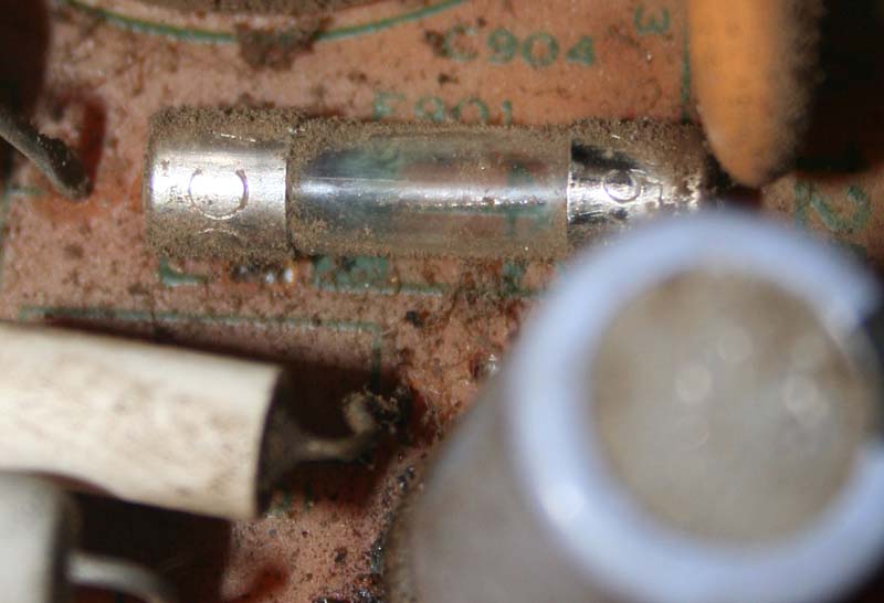

What does F901 look like (the little one, on the other side of the large electrolytic cap).

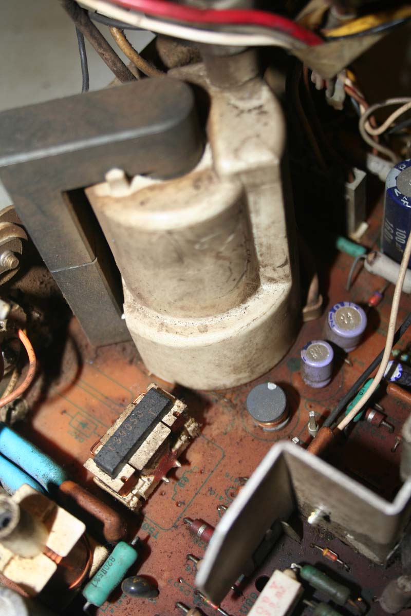

What does the flyback look like?

Hard to tell from the photo of F901, but it might be blown. Check it. If it is, you most certainally need a flyback and a HOT.
Speaking of flyback, that picture you posted is a neckboard, not a flyback. The flyback is the grey block with two knobs and the thick wire coming out of it.
As for the caps - yeah, those are pretty bad looking, you're definitely due to recap that. But usually they only cause picture distortion, foldover, sync problems, etc. The right bad cap can cause a dead monitor, but usually on a G07 it's the flyback that goes.
Take a look at the flyback, see if there are any cracks or burn marks on it. And check the little fuse (F901) to see if it's open.

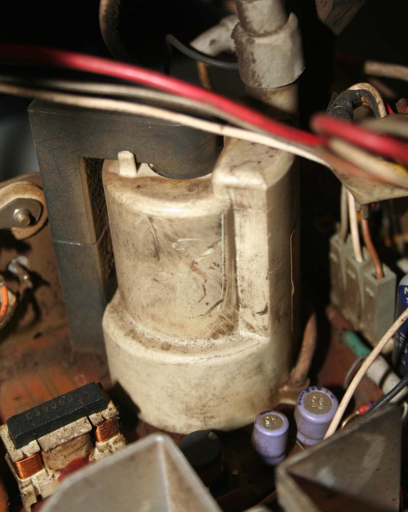

Gee sorry! - don´t know what i was thinking with the neckboard pic...
Well, Bob Roberts is out of the question - because i´m in Denmark, and the way the payment has to be, is near to impossible for me - i wish he would accept a direct money transfer from my bank account to his bank account.....
back on topic:
The flyback looks ok to me..

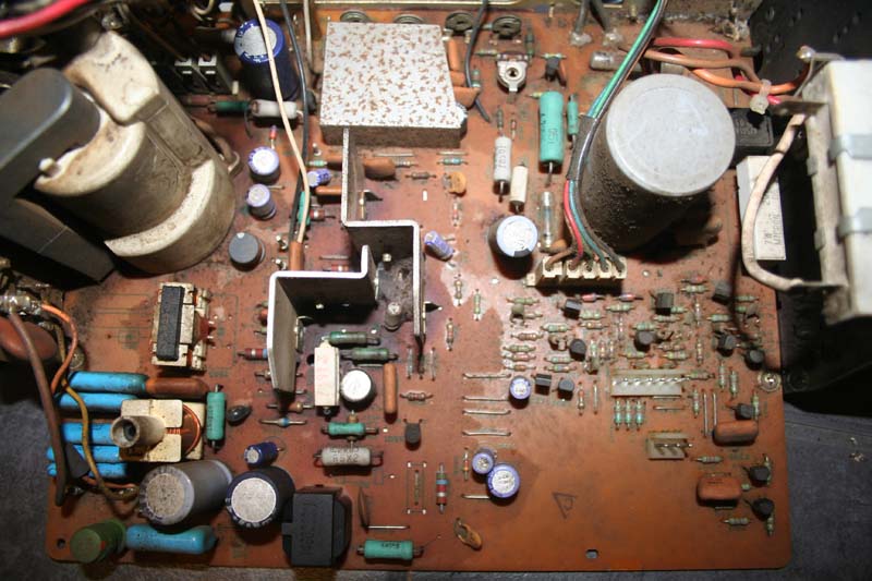

Under the flyback:
Theres some residue on the PCB to, maby it´s from the blovn cap?
I dont think the F901 is blown....
regardless of where you get it from you need to cap and replace the flyback...find someone to send you a g07 deluxe kit...it should get you back up and running for years to come.
