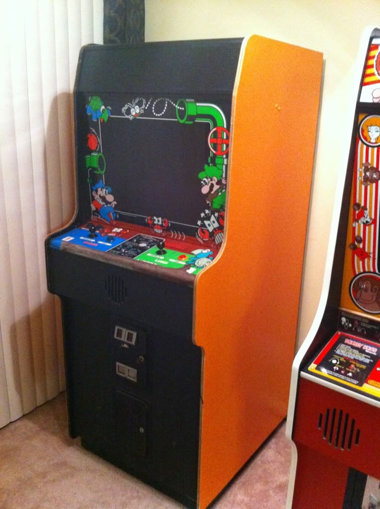

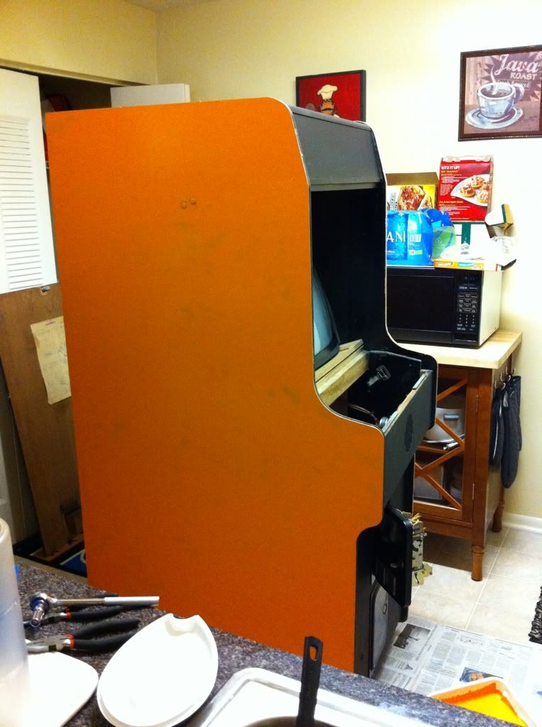

Just painted the cab. Not perfect, looks better in the pictures and I was getting pissed trying to remove the bolts on the side so I just painted over them. I'll deal with them later.
In the kitchen
In it's place
Next to DK
Now I need the artwork.
Thanks. The first pic was after the first coat, so there was a little black peeking through. That is gone now.
I've decided not to paint the front because I hate black paint and it looks decent. I might vinyl it. Idk.
I sanded and painted the brackets as well
Excellent Job so far man! So glad this went to a good home. IF i still had it it would literally be just sitting in that basement still lol. THATS HILARIOUS YOUR PAINTING IT IN THE KITCHEN, your wife was actually down for that? Mine would kill me lol.
oh and yea i wouldnt worry too much aboutthe bolts until you get the side art. When you apply the side art definitely get take thebolts out before applying, then sand off the paint on the bolts (or get new ones). Always look nice
Well it's either in the kitchen or in the dinning area, which is carpeted and where my games currently reside... Lol I'm in a 1 bedroom apartment. 860sqft

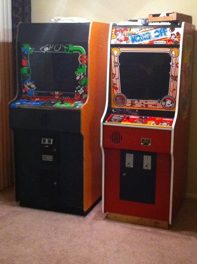

Got the Marquee today and put on the T-Molding. Time for a side-by-side before and after.
I am hoping that the audio cable comes tomorrow or by the weekend, and then I hope the audio is working, otherwise Ill have more problems :(. I still need to wire the coin door lights as well, and Im gonna have my cousin buff the scratches out of my bezel.
