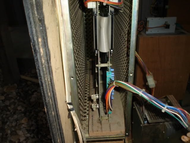

but after opening up the pcb cage i may have found the root of the problem

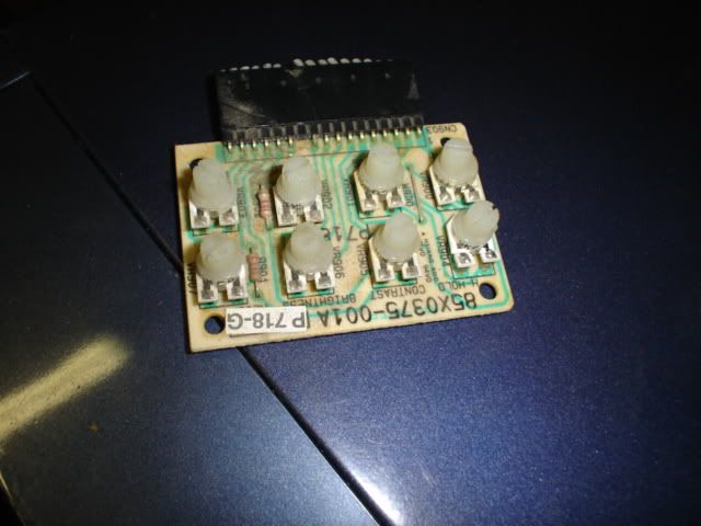

the pots on the pcb
the top pot works in adjusting the horz
the bottom pot is not doing anything at all i can see no change at all no matter wich way i turn it
i sprayed it down with some pot cleaner/lube and worked it back an forth and still no affect when turning the pot

The boardset has 2 pots side by side. 1 is H position and 1 is V position. The other pot on the board is for sound.
her is what im looking at
(two pots at the bottom left)
top pot adjusts the horz (left right oreantation)
bottom pot does nothing at all
so since it is not affecting the screen pos at all then im guessing i have a bad trace or bad pot
since im going to the elect supply tommorow for the 200 k pot for the v hold i am going to go ahead an purchase one for the v pos also as it seems that is my main ishus (i can get the screen to hold but when i do the bottom of the screen is in the middle of the tube)

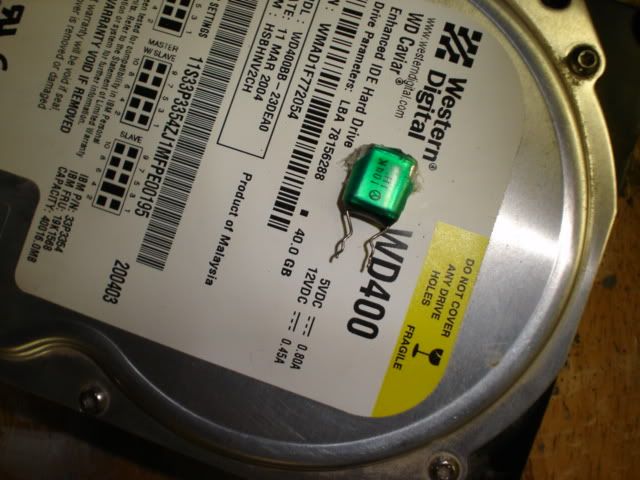

0.1 uf 50 v film cap at location c3 on vid board (mine looks exploded can someone verfy it functon also)

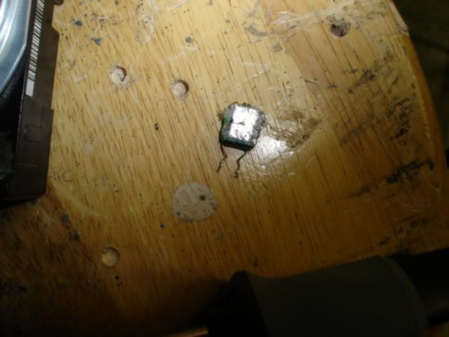

i thought id close this out by saying thanks to all that helped me and let everyone know the fix to my problem
my problem was not with either pots or the monitor itself but with the .1 uf 50 v film cap located at c3 on the vid board
luckly this cap was so easy to spot as being bad
i replaced it with a .1 uf 100 v mylar cap from my local elect supply store and now my monitor is as good as new
