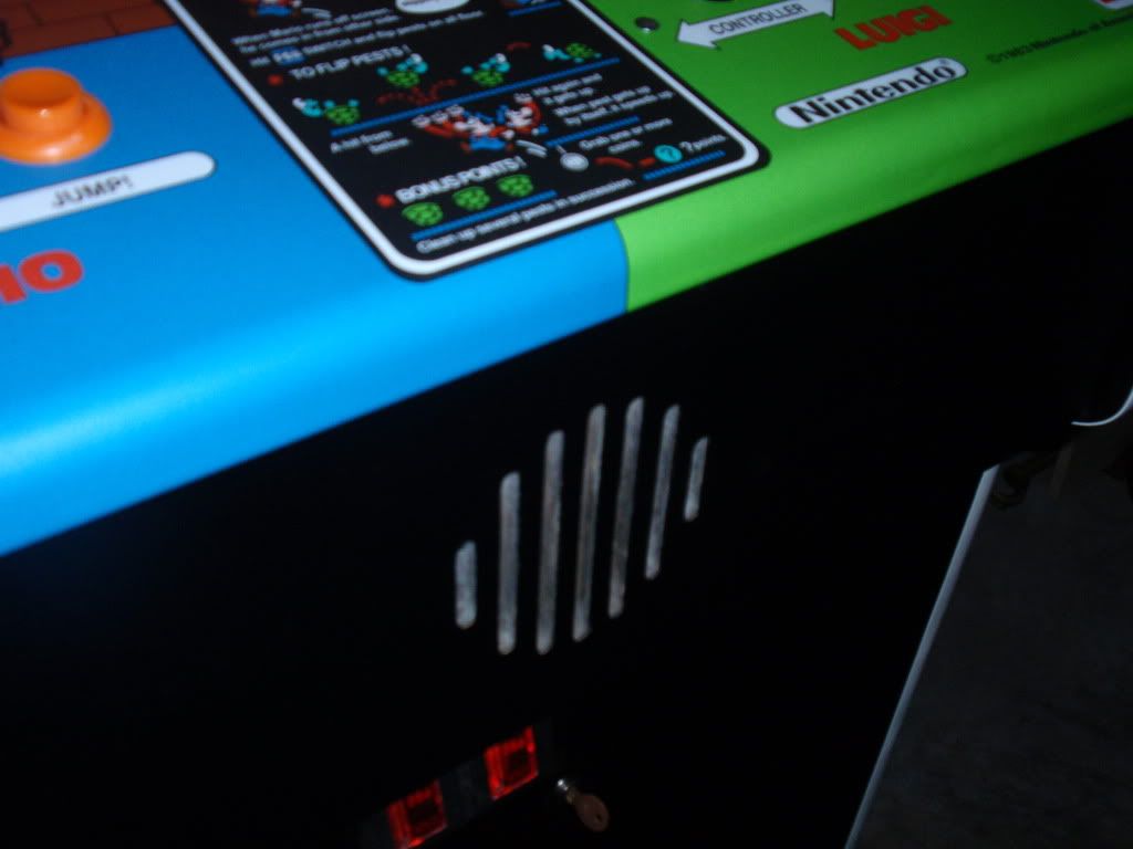

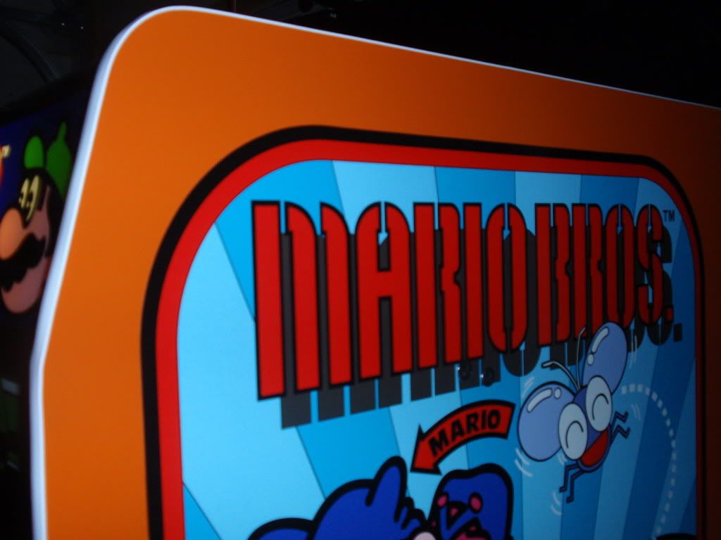

I picked this game up over 3 years ago and finally got around to restoring it. One of my favs, I remember first playing it with my brother at Griff's Pizza in Long Prairie in about '86. I picked this one up from a kid's basement back in '06. I bought it from him in a mini bulk deal. Got a working Asteroids, working Cosmic Avenger and this working widebody, all for $400 cash money. This one was in the worst shape of the 3. It smelled of mildew, had flaking paint and shredded plywood, monitor needed a cap kit in a bad way, T-molding was yellow and brittle, most of it was broken, hardware was rusty, CPO was tore and someone had tried to spray paint the missing ares blue. The base was in rough, rotting shape, this game had obviously sat in water/wetness for a very long time. I stripped it, cleaned it, sanded, primed, painted and installed Rich's Orange Vinyl kit. Buffed the bezel and marquee, installed new CPO from QA, bought the side art from Brentradio. I am still looking for my before pics, but here are some after shots:
Here's a cropped and crappy before pic. You can make out the poorly spray painted front and the f'ed up CPO:
and now:

Looks flawless. Great job! You say you had it for 3 years but, how long did the actual restoration take?
I moved that machine into the shop in Early August? So 2 and a half months or so. The more kids I accumulate, the slower I get.
